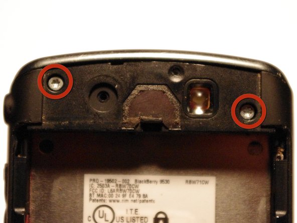

  4. BlackBerry Storm 9530 Logic/Motherboard Replacement: crwdns2935265:04crwdnd2935265:01crwdnd2935265:02crwdne2935265:0 BlackBerry Storm 9530 Logic/Motherboard Replacement: crwdns2935265:04crwdnd2935265:02crwdnd2935265:02crwdne2935265:0
    • Remove the plastic piece that covers the camera & flash on the back . This is held in with some tape so use a safe pry tool.
    • Remove the two hex screws underneath it.

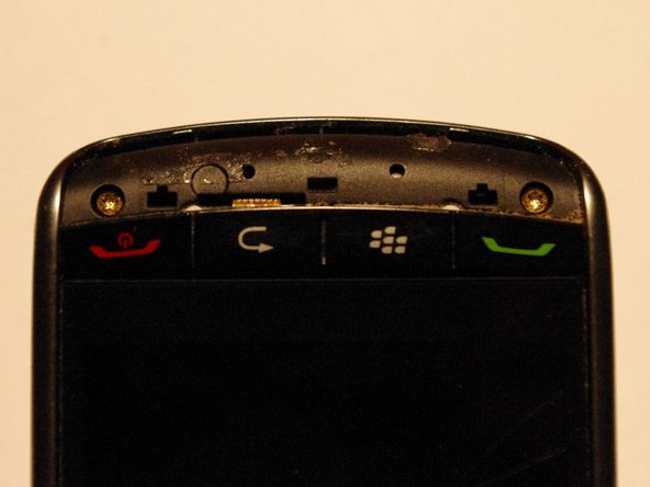

  5. BlackBerry Storm 9530 Logic/Motherboard Replacement: crwdns2935265:05crwdnd2935265:01crwdnd2935265:03crwdne2935265:0 BlackBerry Storm 9530 Logic/Motherboard Replacement: crwdns2935265:05crwdnd2935265:02crwdnd2935265:03crwdne2935265:0 BlackBerry Storm 9530 Logic/Motherboard Replacement: crwdns2935265:05crwdnd2935265:03crwdnd2935265:03crwdne2935265:0
    • Turn the phone over and remove the plastic cover under the buttons as shown.
    • Remove the 2 screws underneath.

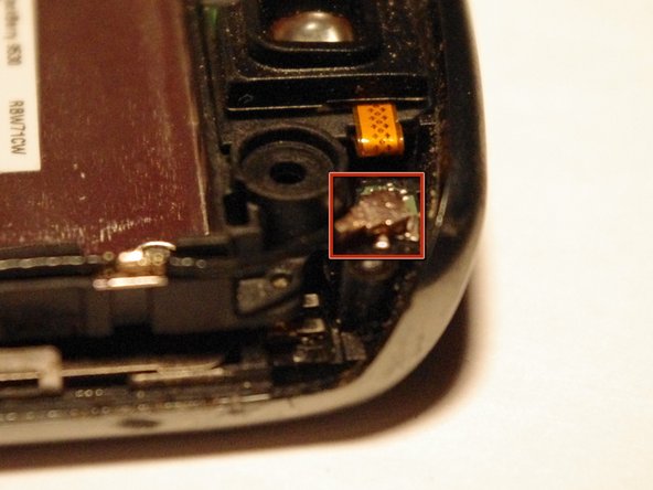

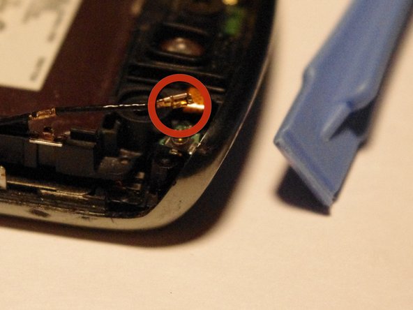

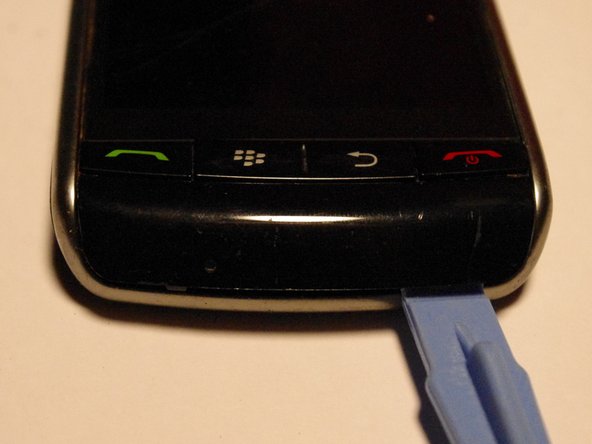

  6. BlackBerry Storm 9530 Logic/Motherboard Replacement: crwdns2935265:06crwdnd2935265:01crwdnd2935265:03crwdne2935265:0 BlackBerry Storm 9530 Logic/Motherboard Replacement: crwdns2935265:06crwdnd2935265:02crwdnd2935265:03crwdne2935265:0 BlackBerry Storm 9530 Logic/Motherboard Replacement: crwdns2935265:06crwdnd2935265:03crwdnd2935265:03crwdne2935265:0
    • Go around your device with the plastic pry tool, there a 3 clips on each side of the housing.
    • There is a connection for the antenna from the front to mid housing. Remove it with a pry tool if it does not come off by itself.

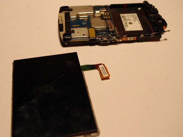

  8. BlackBerry Storm 9530 Logic/Motherboard Replacement: crwdns2935265:08crwdnd2935265:01crwdnd2935265:02crwdne2935265:0 BlackBerry Storm 9530 Logic/Motherboard Replacement: crwdns2935265:08crwdnd2935265:02crwdnd2935265:02crwdne2935265:0
    • To remove the screen gently pry up this ribbon cable with a pry tool.

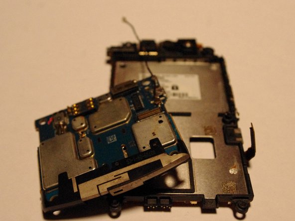

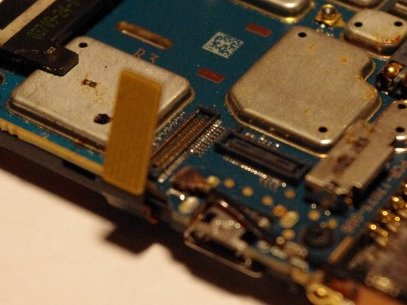

  9. BlackBerry Storm 9530 Logic/Motherboard Replacement: crwdns2935265:09crwdnd2935265:01crwdnd2935265:03crwdne2935265:0 BlackBerry Storm 9530 Logic/Motherboard Replacement: crwdns2935265:09crwdnd2935265:02crwdnd2935265:03crwdne2935265:0 BlackBerry Storm 9530 Logic/Motherboard Replacement: crwdns2935265:09crwdnd2935265:03crwdnd2935265:03crwdne2935265:0
    • To remove the main board from the mid housing disconnect the ribbon cable as pictured.
    • Now follow in reverse order for reassembly!
