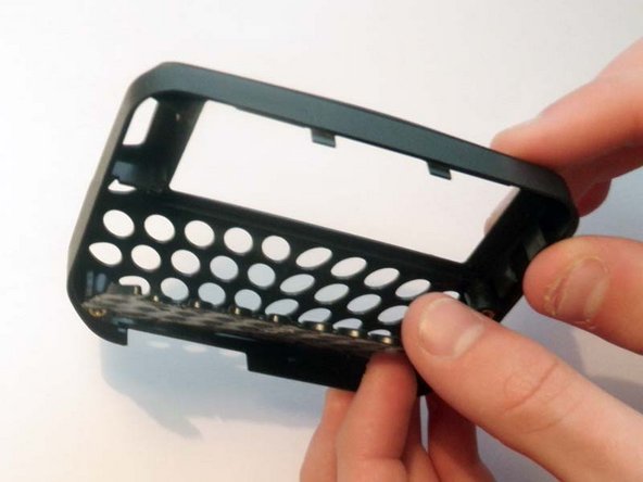

  6. BlackBerry R900M Keypad Replacement, Keypad: crwdns2935265:06crwdnd2935265:01crwdnd2935265:02crwdne2935265:0 BlackBerry R900M Keypad Replacement, Keypad: crwdns2935265:06crwdnd2935265:02crwdnd2935265:02crwdne2935265:0
    • Flip the newly separated front portion of the casing over so that the front of the device is facing upwards, causing the keypad to fall loose.
