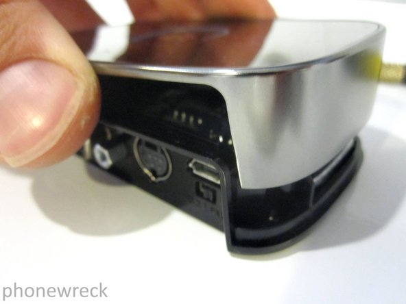

  2. BlackBerry Presenter Teardown: crwdns2935265:02crwdnd2935265:01crwdnd2935265:01crwdne2935265:0
    • Moving around the back, we see all of the ports
    • VGA Port
    • S Video Port
    • Micro Usb
    • NTSC/PAl Switch

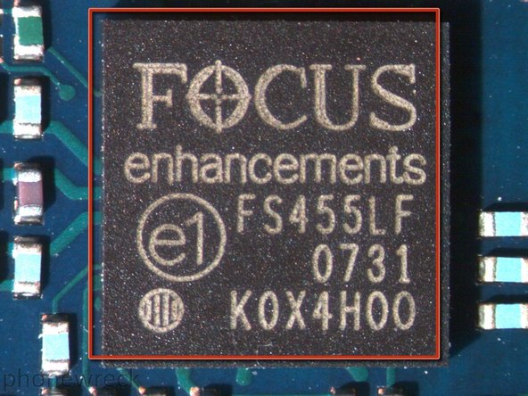

  7. BlackBerry Presenter Teardown: crwdns2935265:07crwdnd2935265:01crwdnd2935265:02crwdne2935265:0 BlackBerry Presenter Teardown: crwdns2935265:07crwdnd2935265:02crwdnd2935265:02crwdne2935265:0
    • Focus Enchancments : FS455LF 0731 kox4h00 is a TV encoder designed for applications which require Component Video, VGA, or RGB output capabilities.It can accept digital video or computer graphics in many different resolutions and rates, and convert them to high quality analog video.
    • TI TMS320 DM350ZWX
    • ST microelectronics
