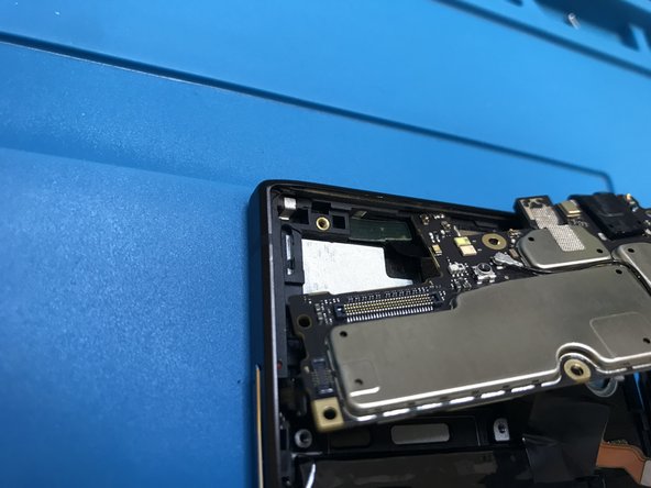

    • The start of our disassembly. Turn off your device before start.
    • Remove the sim card bracket.

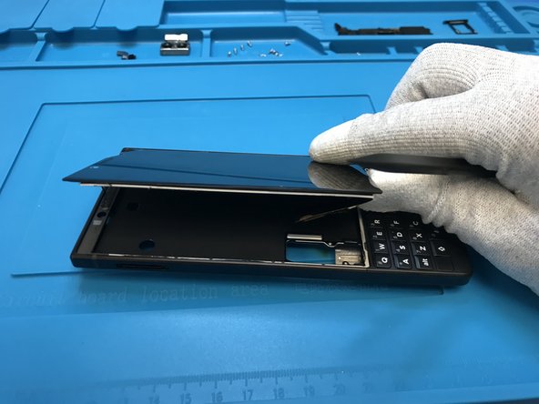

  2. BlackBerry Key2 Disassembly, Heating process: crwdns2935265:02crwdnd2935265:01crwdnd2935265:03crwdne2935265:0 BlackBerry Key2 Disassembly, Heating process: crwdns2935265:02crwdnd2935265:02crwdnd2935265:03crwdne2935265:0 BlackBerry Key2 Disassembly, Heating process: crwdns2935265:02crwdnd2935265:03crwdnd2935265:03crwdne2935265:0
    • Apply heat to the back of the phone to remove the plastic cover.
    • With a pry tool of your preference start to lift up the back cover. Be careful on that part of the process.

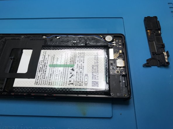

  3. BlackBerry Key2 Disassembly, Removing the screws: crwdns2935265:03crwdnd2935265:01crwdnd2935265:03crwdne2935265:0 BlackBerry Key2 Disassembly, Removing the screws: crwdns2935265:03crwdnd2935265:02crwdnd2935265:03crwdne2935265:0 BlackBerry Key2 Disassembly, Removing the screws: crwdns2935265:03crwdnd2935265:03crwdnd2935265:03crwdne2935265:0
    • Remove all the screws.
    • Remove the loudspeaker module.

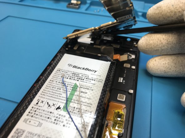

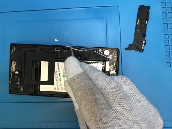

  4. BlackBerry Key2 Disassembly, Antenna cable: crwdns2935265:04crwdnd2935265:01crwdnd2935265:03crwdne2935265:0 BlackBerry Key2 Disassembly, Antenna cable: crwdns2935265:04crwdnd2935265:02crwdnd2935265:03crwdne2935265:0 BlackBerry Key2 Disassembly, Antenna cable: crwdns2935265:04crwdnd2935265:03crwdnd2935265:03crwdne2935265:0
    • Use the point of a plastic spudger to lift the antenna cable connector up off of its socket on the logic board.

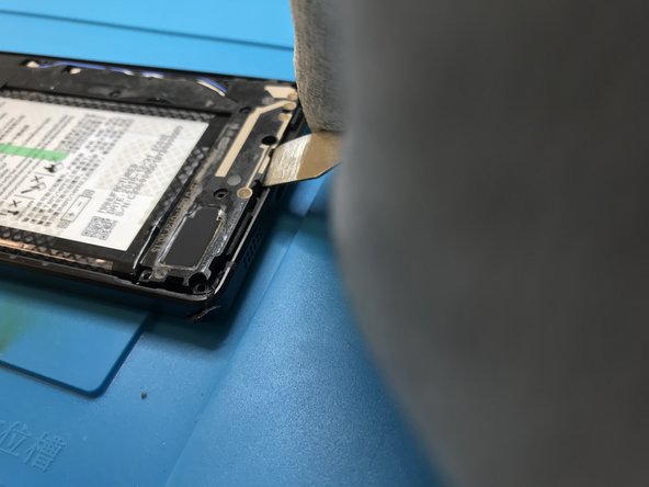

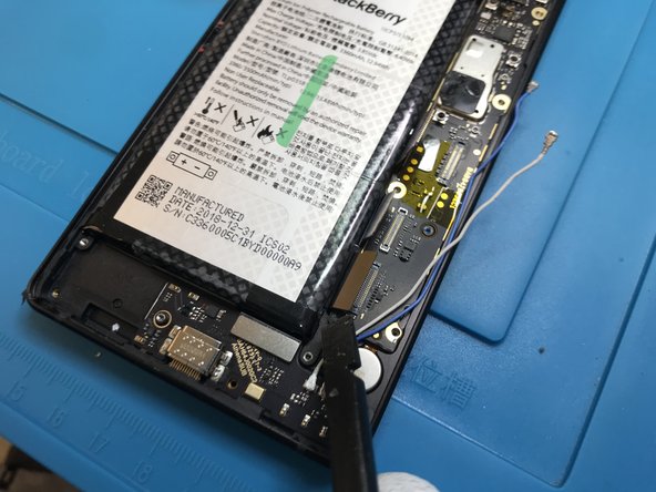

  5. BlackBerry Key2 Disassembly, Back bracket: crwdns2935265:05crwdnd2935265:01crwdnd2935265:03crwdne2935265:0 BlackBerry Key2 Disassembly, Back bracket: crwdns2935265:05crwdnd2935265:02crwdnd2935265:03crwdne2935265:0 BlackBerry Key2 Disassembly, Back bracket: crwdns2935265:05crwdnd2935265:03crwdnd2935265:03crwdne2935265:0
    • Be gentle lifting up the back bracket.
    • I marked in red all the flex cables connected on the motherboard. You got to remove them all.
    • Start disconnecting the battery flex cable.

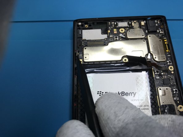

  6. BlackBerry Key2 Disassembly, Removing the flex cables: crwdns2935265:06crwdnd2935265:01crwdnd2935265:03crwdne2935265:0 BlackBerry Key2 Disassembly, Removing the flex cables: crwdns2935265:06crwdnd2935265:02crwdnd2935265:03crwdne2935265:0 BlackBerry Key2 Disassembly, Removing the flex cables: crwdns2935265:06crwdnd2935265:03crwdnd2935265:03crwdne2935265:0
    • Disconnect and remove the rear camera.
    • Then continue disconnecting the other flex cables.
    • Don't forget to use a plastic tool.

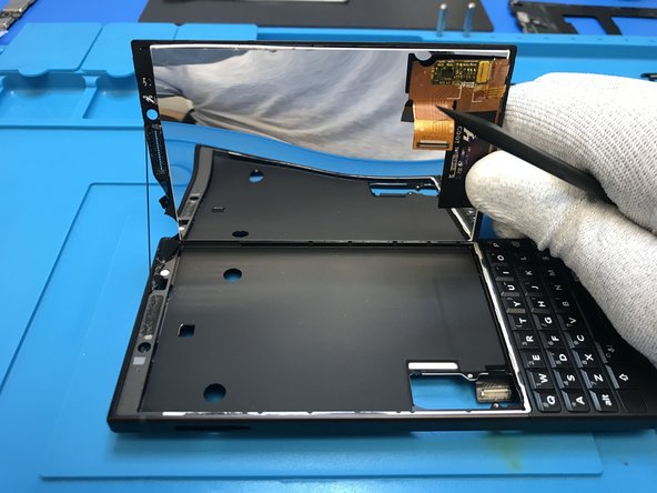

  8. BlackBerry Key2 Disassembly, Removing the LCD.: crwdns2935265:08crwdnd2935265:01crwdnd2935265:03crwdne2935265:0 BlackBerry Key2 Disassembly, Removing the LCD.: crwdns2935265:08crwdnd2935265:02crwdnd2935265:03crwdne2935265:0 BlackBerry Key2 Disassembly, Removing the LCD.: crwdns2935265:08crwdnd2935265:03crwdnd2935265:03crwdne2935265:0
    • Heat the LCD before lift.

The antenna connector on the daughter board can be broken off really easily. Pop off the connectors carefully. A hot air workstation will make quick work of re attaching tho.
Grant Marshall - crwdns2934203:0crwdne2934203:0 crwdns2950251:0crwdne2950251:0
OMG that’s probably exactly what happened to me. now the phone does not receive network anymore any suggestions on what to do ?? i am quite certain i cannot get another antenna or board. do you think i can find a matching antenna from another phone entirely ???
Chinedu - crwdns2934203:0crwdne2934203:0 crwdns2950251:0crwdne2950251:0
Thanks for this tear down! At what step can the battery be removed? It *appears* to be mid-step-5
charleslindsay - crwdns2934203:0crwdne2934203:0 crwdns2950251:0crwdne2950251:0
Same her no Network so my Key2 ist useless :/
