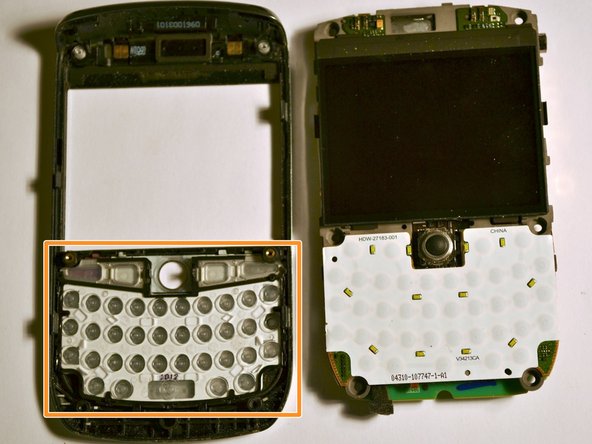

  5. BlackBerry Curve 8900 Speaker Replacement: crwdns2935265:05crwdnd2935265:01crwdnd2935265:01crwdne2935265:0
    • Gently remove the mid-frame from the phone, exposing the motherboard.
    • This is the motherboard.
  6. BlackBerry Curve 8900 Speaker Replacement: crwdns2935265:06crwdnd2935265:01crwdnd2935265:02crwdne2935265:0 BlackBerry Curve 8900 Speaker Replacement: crwdns2935265:06crwdnd2935265:02crwdnd2935265:02crwdne2935265:0
    • Gently pull back the plastic tabs that secure the motherboard to the case.
    • Slowly pull the tabs, working your way around the case, until they are lifted and the motherboard is free.
    • Remove the motherboard.
    • The keypad and navigation ball may become loose and fall off the motherboard.

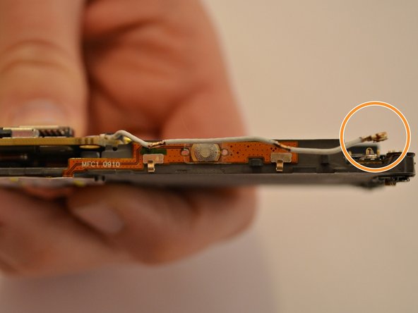

  7. BlackBerry Curve 8900 Speaker Replacement: crwdns2935265:07crwdnd2935265:01crwdnd2935265:02crwdne2935265:0 BlackBerry Curve 8900 Speaker Replacement: crwdns2935265:07crwdnd2935265:02crwdnd2935265:02crwdne2935265:0
    • Carefully detach the antenna from the two clips on the side of the motherboard.
    • Disconnect the antenna from the motherboard in the same manner.

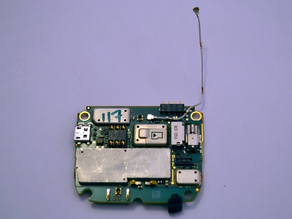

  8. BlackBerry Curve 8900 Speaker Replacement: crwdns2935265:08crwdnd2935265:01crwdnd2935265:01crwdne2935265:0
    • Carefully disconnect the ribbon cable located on the bottom right of the motherboard.

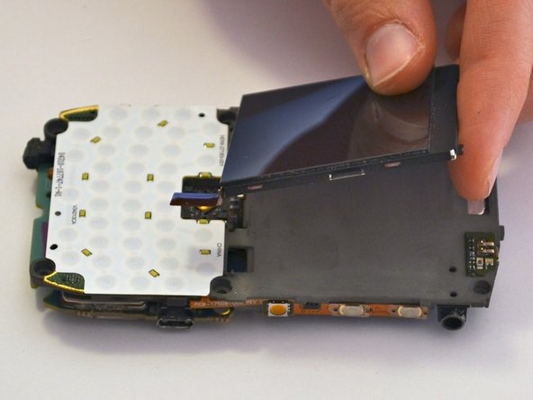

  9. BlackBerry Curve 8900 Speaker Replacement: crwdns2935265:09crwdnd2935265:01crwdnd2935265:02crwdne2935265:0 BlackBerry Curve 8900 Speaker Replacement: crwdns2935265:09crwdnd2935265:02crwdnd2935265:02crwdne2935265:0
    • Locate the chip underneath the screen.
    • Gently remove the screen, without applying too much pressure, taking care not to damage it.
  10. BlackBerry Curve 8900 Speaker Replacement: crwdns2935265:010crwdnd2935265:01crwdnd2935265:02crwdne2935265:0 BlackBerry Curve 8900 Speaker Replacement: crwdns2935265:010crwdnd2935265:02crwdnd2935265:02crwdne2935265:0
    • Lift up the motherboard from the bottom edge to reveal the ribbon cables.
    • Carefully disconnect the two ribbon cables connecting the motherboard to the display on either side.
    • Remove the motherboard and place off to the side.
