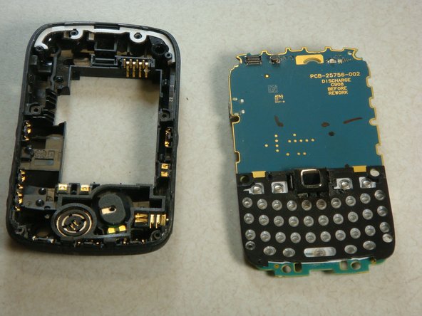

  9. BlackBerry Curve 8530 Trackpad Replacement, Motherboard: crwdns2935265:09crwdnd2935265:01crwdnd2935265:02crwdne2935265:0 BlackBerry Curve 8530 Trackpad Replacement, Motherboard: crwdns2935265:09crwdnd2935265:02crwdnd2935265:02crwdne2935265:0

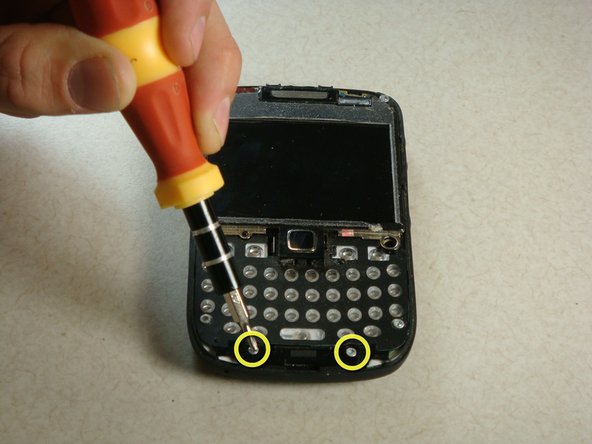

    • Now there are four screws that need to be removed. They are located at the bottom of the phone and can also be removed using a T6 Torx Screwdriver.

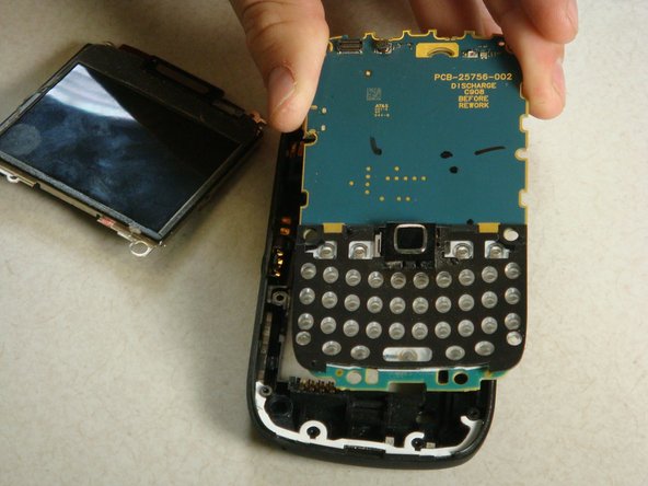

  10. BlackBerry Curve 8530 Trackpad Replacement: crwdns2935265:010crwdnd2935265:01crwdnd2935265:03crwdne2935265:0 BlackBerry Curve 8530 Trackpad Replacement: crwdns2935265:010crwdnd2935265:02crwdnd2935265:03crwdne2935265:0 BlackBerry Curve 8530 Trackpad Replacement: crwdns2935265:010crwdnd2935265:03crwdnd2935265:03crwdne2935265:0
    • Now the motherboard will lift up out of the plastic backing of the phone.

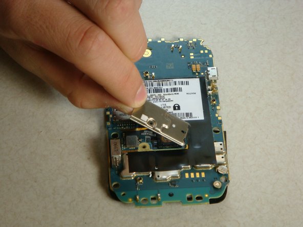

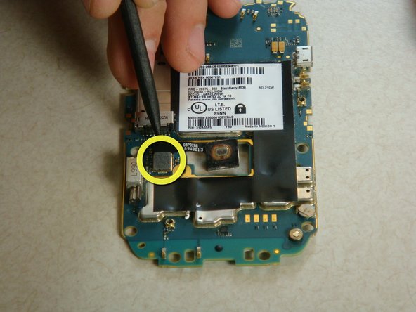

  11. BlackBerry Curve 8530 Trackpad Replacement, Trackpad: crwdns2935265:011crwdnd2935265:01crwdnd2935265:03crwdne2935265:0 BlackBerry Curve 8530 Trackpad Replacement, Trackpad: crwdns2935265:011crwdnd2935265:02crwdnd2935265:03crwdne2935265:0 BlackBerry Curve 8530 Trackpad Replacement, Trackpad: crwdns2935265:011crwdnd2935265:03crwdnd2935265:03crwdne2935265:0
    • Flip over the motherboard.
    • There is another torx screw near the middle of the motherboard on the left side.
    • Using the T5 Torx Screwdriver, remove the screw and the metal casing.
    • Note: Distinguish this screw from the others for reassembly purposes.
    • Detach the clip holding the track pad in.
  12. BlackBerry Curve 8530 Trackpad Replacement: crwdns2935265:012crwdnd2935265:01crwdnd2935265:01crwdne2935265:0
    • Remove the trackpad from the motherboard.
    • Now you are ready to reassemble the phone
