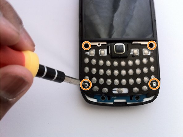

  6. BlackBerry Curve 8520 Motherboard Replacement: crwdns2935265:06crwdnd2935265:01crwdnd2935265:03crwdne2935265:0 BlackBerry Curve 8520 Motherboard Replacement: crwdns2935265:06crwdnd2935265:02crwdnd2935265:03crwdne2935265:0 BlackBerry Curve 8520 Motherboard Replacement: crwdns2935265:06crwdnd2935265:03crwdnd2935265:03crwdne2935265:0
    • Remove four T6 Torx screws from the front of the phone.
    • Using tweezers, remove the keyboard buttons from the phone.
  7. BlackBerry Curve 8520 Motherboard Replacement, Motherboard: crwdns2935265:07crwdnd2935265:01crwdnd2935265:02crwdne2935265:0 BlackBerry Curve 8520 Motherboard Replacement, Motherboard: crwdns2935265:07crwdnd2935265:02crwdnd2935265:02crwdne2935265:0
    • Remove the two T6 Torx screws securing the small plastic bracket at the bottom of the phone.
    • Remove the four T6 Torx screws from the corners of the keyboard.

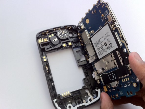

  8. BlackBerry Curve 8520 Motherboard Replacement: crwdns2935265:08crwdnd2935265:01crwdnd2935265:02crwdne2935265:0 BlackBerry Curve 8520 Motherboard Replacement: crwdns2935265:08crwdnd2935265:02crwdnd2935265:02crwdne2935265:0
    • Using a plastic opening tool, gently pry the motherboard assembly from the device's frame.
