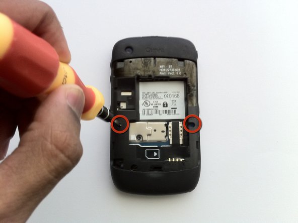

  3. BlackBerry Curve 8520 Keyboard Cover Replacement, Keyboard Cover: crwdns2935265:03crwdnd2935265:01crwdnd2935265:02crwdne2935265:0 BlackBerry Curve 8520 Keyboard Cover Replacement, Keyboard Cover: crwdns2935265:03crwdnd2935265:02crwdnd2935265:02crwdne2935265:0
    • Remove the two Torx T6 screws to the left and right of the battery.
