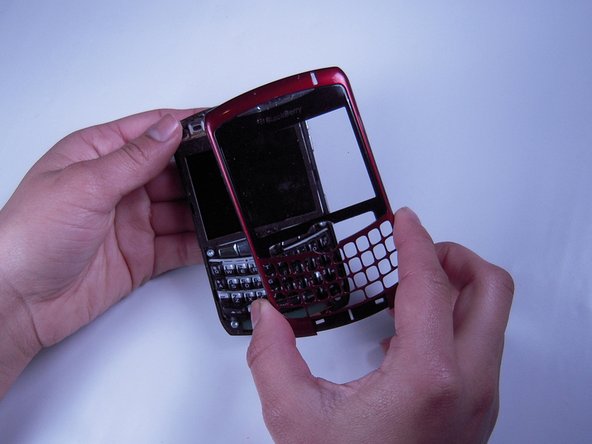

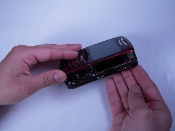

    4. BlackBerry Curve 8310 Lens Replacement: crwdns2935265:06crwdnd2935265:01crwdnd2935265:03crwdne2935265:0 BlackBerry Curve 8310 Lens Replacement: crwdns2935265:06crwdnd2935265:02crwdnd2935265:03crwdne2935265:0 BlackBerry Curve 8310 Lens Replacement: crwdns2935265:06crwdnd2935265:03crwdnd2935265:03crwdne2935265:0
      • Be careful not to damage the front cover's plastic clips while trying to separate it from the phone.
      • Use a spudger to pry the front cover away from the side panels.
      • Work the spudger around the entire phone until the front cover is free.
