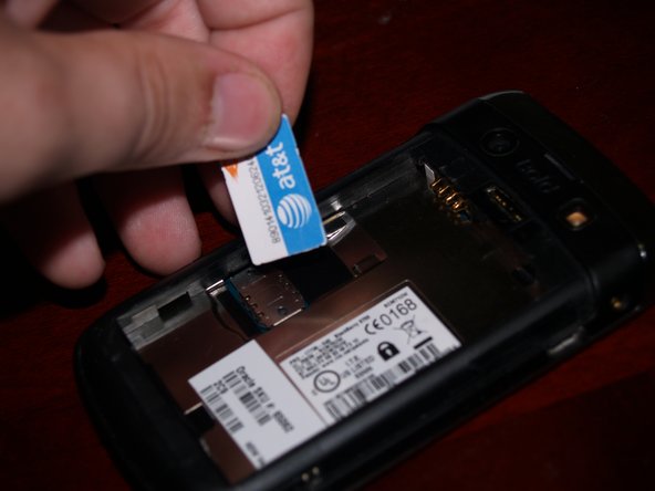

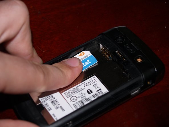

    • Push your sim card up to slide it out from under the slot and then pull the card out and set it aside.

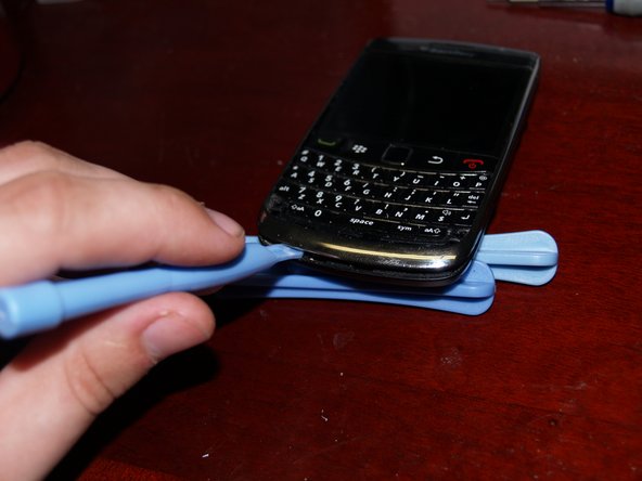

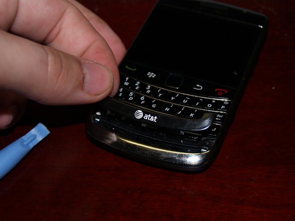

    • Alright, the basics are out of the way, let's tear this sucker apart! First step is to pull off the small plastic strip that rests under the keyboard. Take your plastic spudger or plastic opening tool of choice and work your way under either side of the plastic. Once it is loose enough grab it with your fingers and pull it up towards the top of the phone and set it aside.
    • Be careful about how much pressure you apply to the keyboard. There are tiny silver strips going between each row of keys and these will break very, very easily. If you look closely you can see I have small pieces of the lowest silver strip broken off on both sides. You have been warned!
    • Go figure that the cell companies would pick the very first and easiest piece to remove to stick their ugly corporate branding on. Oh well! If you'd like, feel free to take a bit of fine grit sand paper to the logo on this piece now that you've got it removed!

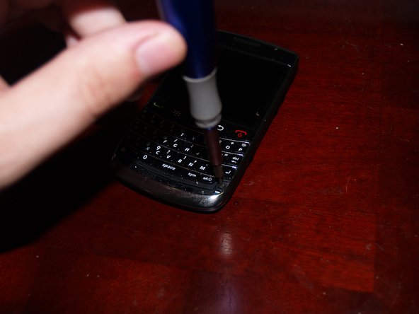

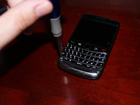

    • With the first piece removed we now have access to the first 2 screws. These are T5 screws so you'll need a small torx screwdriver. I picked up one from Lowe's for 7 or 8 bucks.
    • You'll notice the screw on the left has some white paint over it. This is presumably warranty verification, so if you were excited because you managed to get the plastic strip off without breaking the silver piece on the keyboard, sorry, but the second you stick that screwdriver into the head of that screw your warranty is void, dude.

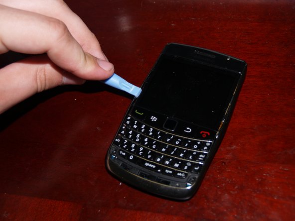

    • There are only a few tabs to release to get the trim off. Take your pry tool and insert it between the lcd and silver trim. It shouldn't take much pressure as the plastic is very flexible. Then slide it down to about where the keys meet the screen and pry it out a bit. You should hear the tab pop out.
    • There is another tab on the opposite side in the same location, centered near where the keys and screen meet.

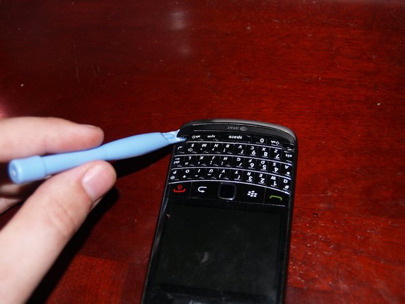

    • Lastly, you'll need to pop a couple more tabs up from under the trim at the bottom of the phone. Don't mind my photography here, I didn't have an assistant so I used a couple extra iPod tools to prop up the phone!

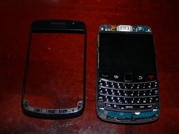

    • Once you've got the tabs from the sides and bottom released lift the trim up from the bottom of the phone and push the whole piece up towards the top of the phone. The section covering the lock and mute buttons should slide off of the section of the phone above the lcd and the whole piece will come off.
    • This phone is remarkably easy to take apart, and all of the sudden the guts are all exposed and stuff!

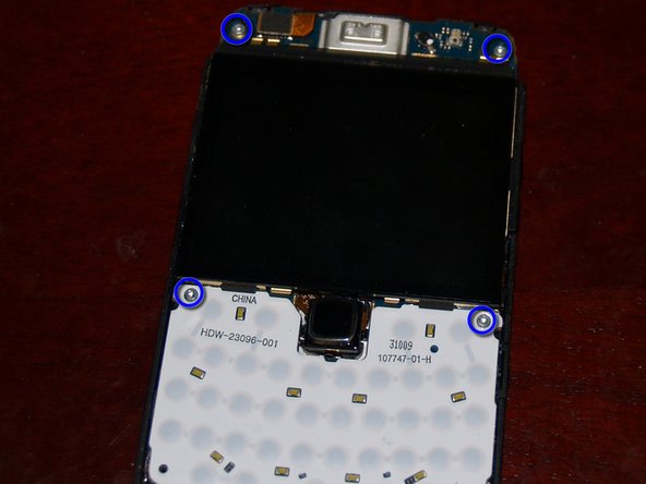

    • The next step is to remove the keypad. There's really nothing holding it on but friction at this point, and it may have fallen off when you removed the trim. But if it's still sitting there go ahead and grab it and pull it off. The trackpad will remain, we will get to that in a minute.
    • With the trim and keypad removed we now have 4 more T5 screws revealed surrounding the LCD. These screws are holding in the mainboard. Go ahead and remove them.
    • These 4 screws are silver, where the first 2 were black. They are also shorter, so make sure you remember that. Shouldn't be too hard.

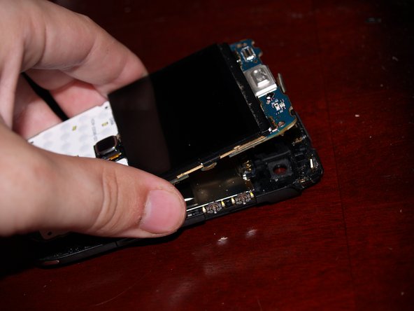

  9. BlackBerry Bold 9700 Teardown: crwdns2935265:09crwdnd2935265:01crwdnd2935265:02crwdne2935265:0 BlackBerry Bold 9700 Teardown: crwdns2935265:09crwdnd2935265:02crwdnd2935265:02crwdne2935265:0
    • Time to remove the mainboard. The only thing left to do before we can pull it out is to disconnect the ribbon connector at the top for the media card slot.
    • Lift the board up near the top of the phone and slide it out away from the bottom of the phone and it should come out easily.
    • Take care when removing the mainboard, as some of the tactile buttons from the side of the phone may fall out. These small pieces are easy to lose, so if they fall out make sure to remember where they went and put them back or set them with the rest of the parts. Don't forget to reattach the buttons to the phone's lower case before replacing the mainboard!

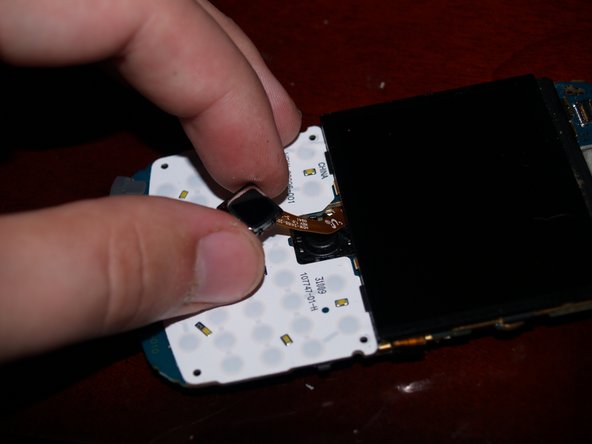

    • The next step is to remove the trackpad. Flip the mainboard over and disconnect the large ribbon connector from the center.
    • Flip the mainboard back over and simply lift the trackpad up and carefully slide the ribbon connector through the opening.
    • Yup, that's all there is to this unique little part. Makes you wonder what took them so long!

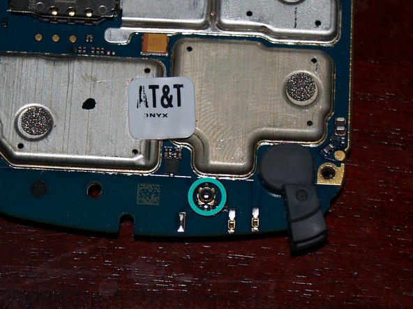

    • I noticed there are a couple of connectors where it appears an external antenna could be connected, but they aren't accessible once the board is inserted into the lower case. Perhaps there were additional plans or a larger antenna planned that didn't pan out?
    • And yes, AT&T has even managed to slap their name inside the phone, and no I didn't mess up that sticker, it was already scratched up like that when I got the phone open!
    • Anyone have any idea what 'ONYX' means? Leave a comment if you think you know!
    • ONYX is the RIM Blackberry codename for the 9700

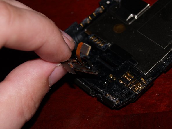

    • Just once piece left to remove, the media card slot. Gently lift the ribbon cable up, and pry the small metal piece up from the lower case using your fingernails.
    • Take care not to put any stress on the tiny and fragile ribbon cable! It will break easily. It is not necessary to peel this cable up from the metal piece below, as they will come up together, and you can't take the ribbon cable off anyways.
    • Slide the slot up and out of the lower case. That's it!!

ONYX is indicating which phone it is. In this case you have the AT&T ONYX Blackberry Bold 9700 2.
