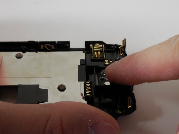

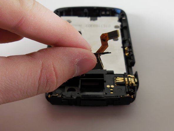

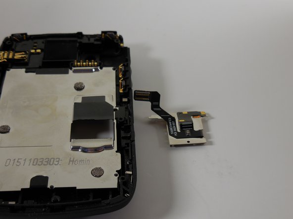

    1. BlackBerry Bold 9700 Memory Card Socket Replacement, Memory Card Socket: crwdns2935265:011crwdnd2935265:01crwdnd2935265:03crwdne2935265:0 BlackBerry Bold 9700 Memory Card Socket Replacement, Memory Card Socket: crwdns2935265:011crwdnd2935265:02crwdnd2935265:03crwdne2935265:0 BlackBerry Bold 9700 Memory Card Socket Replacement, Memory Card Socket: crwdns2935265:011crwdnd2935265:03crwdnd2935265:03crwdne2935265:0
      • Use plastic opening tool to pry away tiny metal arm that is holding the socket in place.
      • Lift SD memory card socket away from phone housing till it is removed.
    2. BlackBerry Bold 9700 Memory Card Socket Replacement: crwdns2935265:012crwdnd2935265:01crwdnd2935265:02crwdne2935265:0 BlackBerry Bold 9700 Memory Card Socket Replacement: crwdns2935265:012crwdnd2935265:02crwdnd2935265:02crwdne2935265:0
      • Align new SD memory card socket into the socket housing and connect tiny metal arm.
      • Apply pressure to the top of new SD Memory card socket.
      • Once the SD memory card socket is correctly placed in the housing you are done.
