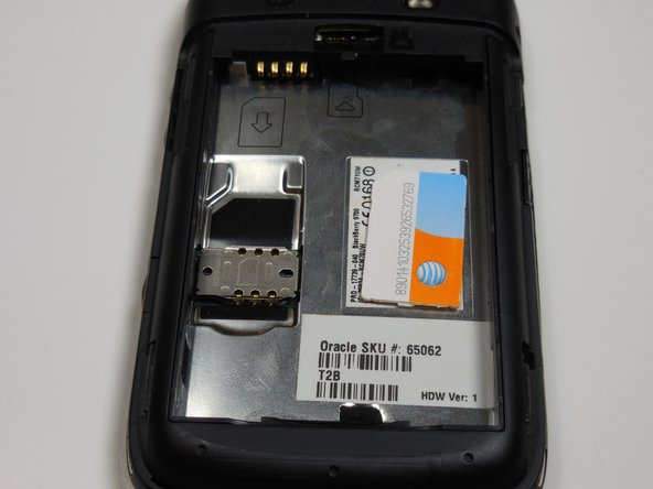

    3. BlackBerry Bold 9700 Keyboard Replacement: crwdns2935265:03crwdnd2935265:01crwdnd2935265:03crwdne2935265:0 BlackBerry Bold 9700 Keyboard Replacement: crwdns2935265:03crwdnd2935265:02crwdnd2935265:03crwdne2935265:0 BlackBerry Bold 9700 Keyboard Replacement: crwdns2935265:03crwdnd2935265:03crwdnd2935265:03crwdne2935265:0
      • Remove the SIM card by pushing the card vertically through the bracket towards the top of the device.
      • The SIM card MUST be removed to disassemble the device.

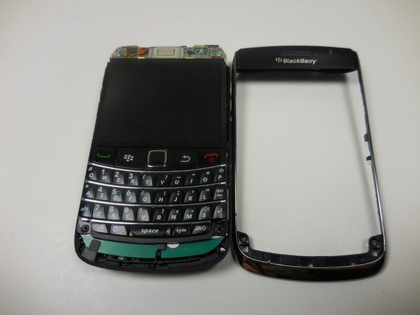

    6. BlackBerry Bold 9700 Keyboard Replacement: crwdns2935265:06crwdnd2935265:01crwdnd2935265:03crwdne2935265:0 BlackBerry Bold 9700 Keyboard Replacement: crwdns2935265:06crwdnd2935265:02crwdnd2935265:03crwdne2935265:0 BlackBerry Bold 9700 Keyboard Replacement: crwdns2935265:06crwdnd2935265:03crwdnd2935265:03crwdne2935265:0
      • Use the plastic opening tool to remove the frame.
      • This will take a bit of effort. You will hear a snapping sound.
    7. BlackBerry Bold 9700 Keyboard Replacement: crwdns2935265:07crwdnd2935265:01crwdnd2935265:03crwdne2935265:0 BlackBerry Bold 9700 Keyboard Replacement: crwdns2935265:07crwdnd2935265:02crwdnd2935265:03crwdne2935265:0 BlackBerry Bold 9700 Keyboard Replacement: crwdns2935265:07crwdnd2935265:03crwdnd2935265:03crwdne2935265:0
      • Gently lift the bottom of the keyboard up with your fingers and pull it toward the bottom of the phone.
