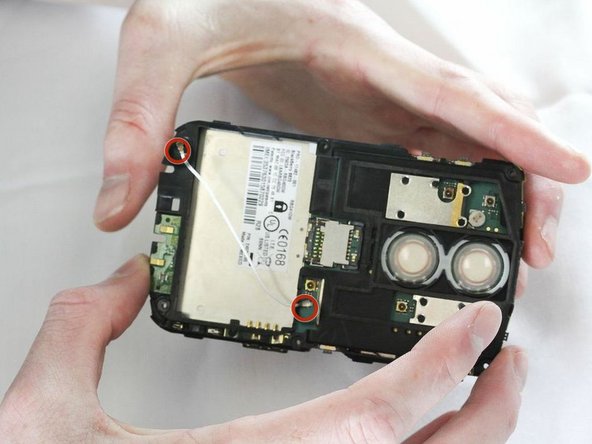

    • Remove the battery by prying under it with your finger or a plastic opening tool.
    • Remove the four small 3/8" long screws using a 1/16" diameter torx screwdriver.

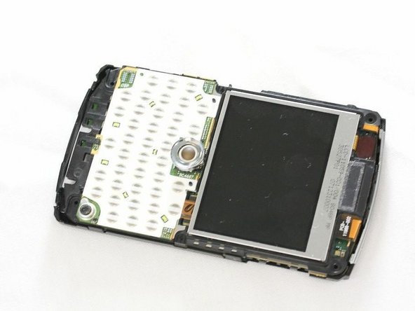

  5. BlackBerry 8820 Motherboard Replacement: crwdns2935265:05crwdnd2935265:01crwdnd2935265:01crwdne2935265:0
    • Pry off the front casing.
    • Be cautious of sensors and other sensitive areas of the newly exposed electronics.

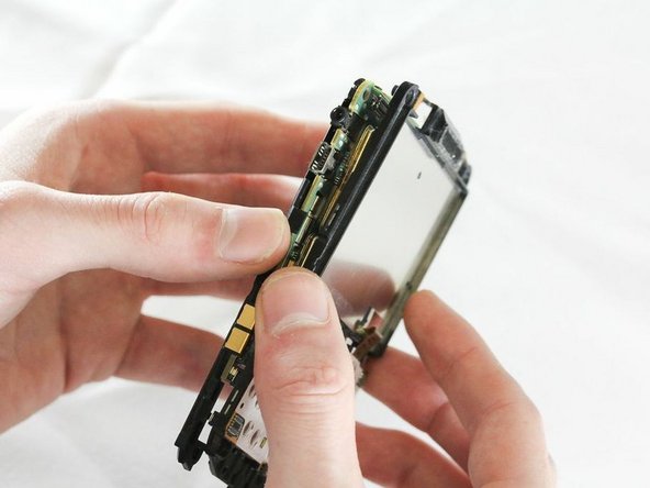

  6. BlackBerry 8820 Motherboard Replacement, Motherboard: crwdns2935265:06crwdnd2935265:01crwdnd2935265:02crwdne2935265:0 BlackBerry 8820 Motherboard Replacement, Motherboard: crwdns2935265:06crwdnd2935265:02crwdnd2935265:02crwdne2935265:0
    • Remove the bottom casing clip, which will easily unsnap when pulled.

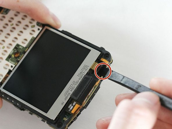

  8. BlackBerry 8820 Motherboard Replacement: crwdns2935265:08crwdnd2935265:01crwdnd2935265:02crwdne2935265:0 BlackBerry 8820 Motherboard Replacement: crwdns2935265:08crwdnd2935265:02crwdnd2935265:02crwdne2935265:0
    • Locate the gloss SATA cable strap connecting LCD screen at the top of the phone.
    • Detach this cable by levering under the connector with a prying tool.
    • Handle with care when removing the ribbon cable handle, it is prone to breaking.

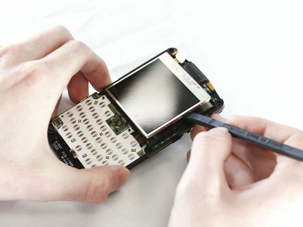

  9. BlackBerry 8820 Motherboard Replacement: crwdns2935265:09crwdnd2935265:01crwdnd2935265:02crwdne2935265:0 BlackBerry 8820 Motherboard Replacement: crwdns2935265:09crwdnd2935265:02crwdnd2935265:02crwdne2935265:0
    • WARNING: Be sure to have disconnected the SATA cable strap before attempting.
    • Using the prying tool, lever the old screen up as shown.

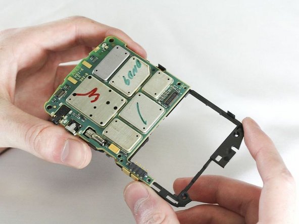

  10. BlackBerry 8820 Motherboard Replacement: crwdns2935265:010crwdnd2935265:01crwdnd2935265:03crwdne2935265:0 BlackBerry 8820 Motherboard Replacement: crwdns2935265:010crwdnd2935265:02crwdnd2935265:03crwdne2935265:0 BlackBerry 8820 Motherboard Replacement: crwdns2935265:010crwdnd2935265:03crwdnd2935265:03crwdne2935265:0
    • There will be two small clips on each side of the motherboard. Unhook each clip one at a time using the plastic opening tool.
    • Once all four clips are unhooked you should be able to pull the motherboard from the casing with your hands.
    • After removing the old motherboard, you can now replace it with a new one.
