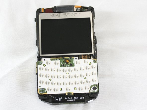

    1. BlackBerry 8820 LCD Screen Replacement, LCD Screen: crwdns2935265:06crwdnd2935265:01crwdnd2935265:01crwdne2935265:0
      • After disassembling the outer casing, the phone should be stripped as shown.

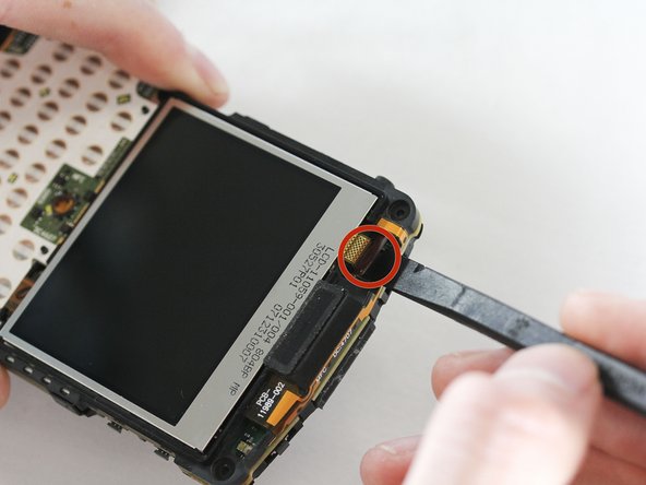

    2. BlackBerry 8820 LCD Screen Replacement: crwdns2935265:07crwdnd2935265:01crwdnd2935265:02crwdne2935265:0 BlackBerry 8820 LCD Screen Replacement: crwdns2935265:07crwdnd2935265:02crwdnd2935265:02crwdne2935265:0
      • At the top of the phone, locate the gloss SATA cable strap connecting the LCD screen to the phone.
      • Using the prying tool, disconnect the SATA cable by levering under the connector.

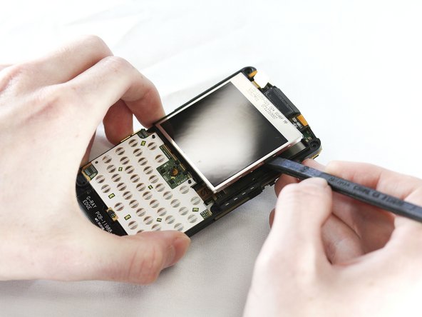

    3. BlackBerry 8820 LCD Screen Replacement: crwdns2935265:08crwdnd2935265:01crwdnd2935265:02crwdne2935265:0 BlackBerry 8820 LCD Screen Replacement: crwdns2935265:08crwdnd2935265:02crwdnd2935265:02crwdne2935265:0
      • Using a spudger, pry up the old screen as shown.
      • Be sure that the SATA cable is disconnected prior to attempting this.
    4. BlackBerry 8820 LCD Screen Replacement: crwdns2935265:09crwdnd2935265:01crwdnd2935265:02crwdne2935265:0 BlackBerry 8820 LCD Screen Replacement: crwdns2935265:09crwdnd2935265:02crwdnd2935265:02crwdne2935265:0
      • Insert the new LCD screen.
      • Attach the cable to the connector located at the top of the phone.
