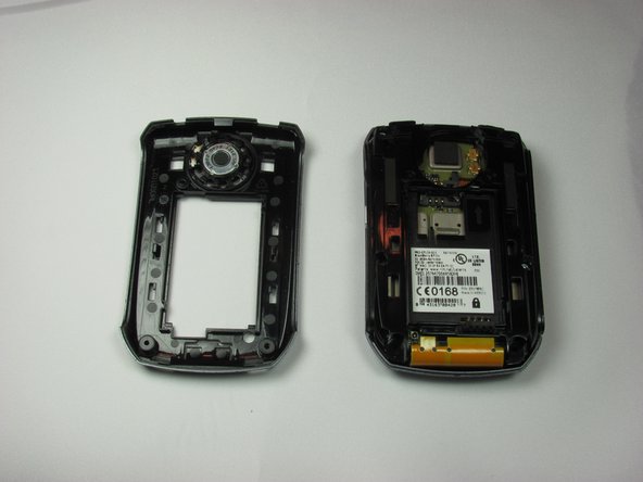

  4. BlackBerry 8700c Replacing Logic Board Replacement: crwdns2935265:04crwdnd2935265:01crwdnd2935265:02crwdne2935265:0 BlackBerry 8700c Replacing Logic Board Replacement: crwdns2935265:04crwdnd2935265:02crwdnd2935265:02crwdne2935265:0
    • Pull the back cover of the phone off and set it aside.

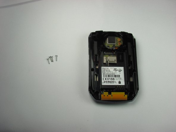

  5. BlackBerry 8700c Replacing Logic Board Replacement: crwdns2935265:05crwdnd2935265:01crwdnd2935265:02crwdne2935265:0 BlackBerry 8700c Replacing Logic Board Replacement: crwdns2935265:05crwdnd2935265:02crwdnd2935265:02crwdne2935265:0
    • Unscrew and remove all 4 T6 Torx screws.

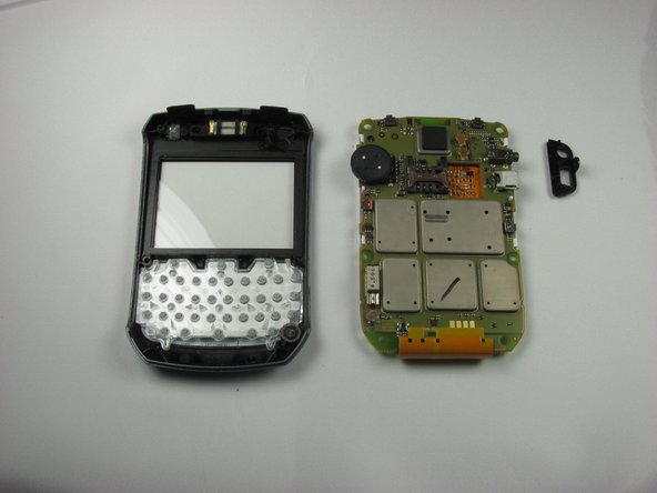

  6. BlackBerry 8700c Replacing Logic Board Replacement: crwdns2935265:06crwdnd2935265:01crwdnd2935265:03crwdne2935265:0 BlackBerry 8700c Replacing Logic Board Replacement: crwdns2935265:06crwdnd2935265:02crwdnd2935265:03crwdne2935265:0 BlackBerry 8700c Replacing Logic Board Replacement: crwdns2935265:06crwdnd2935265:03crwdnd2935265:03crwdne2935265:0
    • Lift and remove inner back cover and set aside.
    • A small side piece may fall away but is simple to reattach.

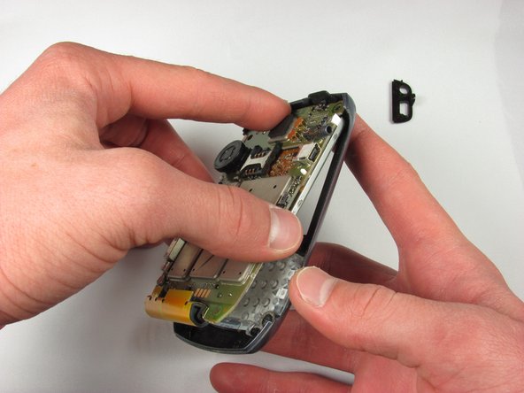

    • Remove logic board by gently lifting it off of the front cover of the phone.
    • New logic board can now simply be set in place.
