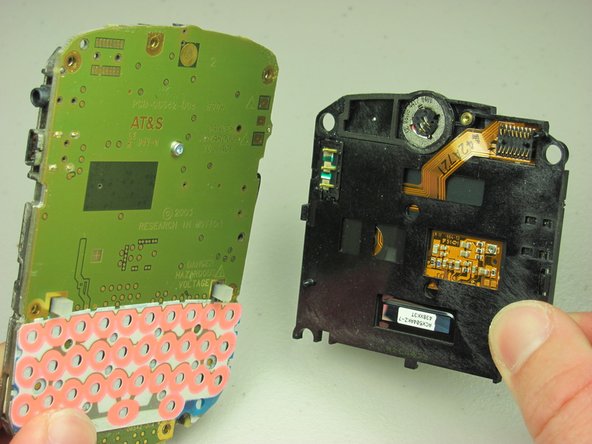

    • Remove the front cover and keypad.
  9. BlackBerry 7510 Logic Board Replacement: crwdns2935265:09crwdnd2935265:01crwdnd2935265:01crwdne2935265:0
    • Remove one T6 Torx screw in the front bottom right of the board.
  10. BlackBerry 7510 Logic Board Replacement: crwdns2935265:010crwdnd2935265:01crwdnd2935265:02crwdne2935265:0 BlackBerry 7510 Logic Board Replacement: crwdns2935265:010crwdnd2935265:02crwdnd2935265:02crwdne2935265:0
    • Carefully pry the screen from the board with your spudger.
    • After prying it up, remove the screen from the board.

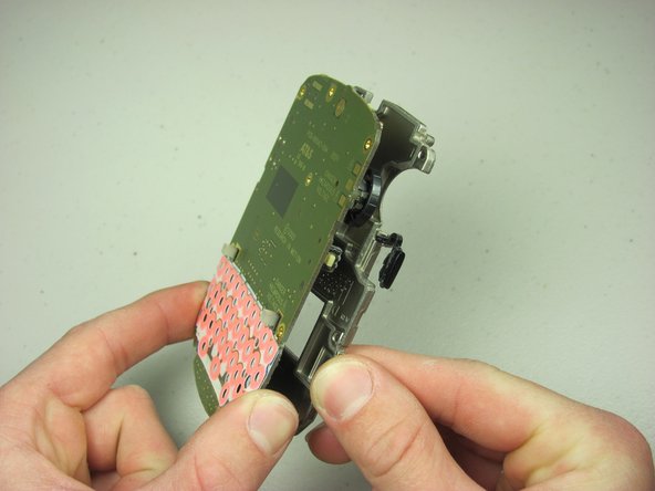

  11. BlackBerry 7510 Logic Board Replacement: crwdns2935265:011crwdnd2935265:01crwdnd2935265:02crwdne2935265:0 BlackBerry 7510 Logic Board Replacement: crwdns2935265:011crwdnd2935265:02crwdnd2935265:02crwdne2935265:0
    • Unscrew center T6 Torx screw in the center of the logic board.
    • Remove the logic board from the phone.
    • Replace with new logic board.
