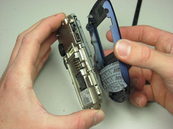

  6. BlackBerry 7510 LCD Screen Replacement, LCD Screen: crwdns2935265:06crwdnd2935265:01crwdnd2935265:01crwdne2935265:0
    • Unscrew the screw holding the back plate.
  7. BlackBerry 7510 LCD Screen Replacement: crwdns2935265:07crwdnd2935265:01crwdnd2935265:02crwdne2935265:0 BlackBerry 7510 LCD Screen Replacement: crwdns2935265:07crwdnd2935265:02crwdnd2935265:02crwdne2935265:0
    • Carefully pry off front cover. Make sure the plastic clips are unlatched before applying force.
    • Lift off front cover from metal plate.

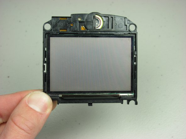

  8. BlackBerry 7510 LCD Screen Replacement: crwdns2935265:08crwdnd2935265:01crwdnd2935265:01crwdne2935265:0
    • Pry off the LCD screen with spudger at the two clips.
  9. BlackBerry 7510 LCD Screen Replacement: crwdns2935265:09crwdnd2935265:01crwdnd2935265:02crwdne2935265:0 BlackBerry 7510 LCD Screen Replacement: crwdns2935265:09crwdnd2935265:02crwdnd2935265:02crwdne2935265:0
    • Remove the LCD screen and replace it with a new one.
    • Careful not to rip the LCD ribbon.
