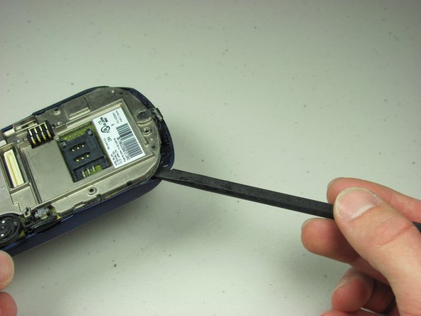

  2. BlackBerry 7510 Keypad Replacement: crwdns2935265:02crwdnd2935265:01crwdnd2935265:01crwdne2935265:0
    • Using your finger nail or a spudger, carefully pry up the back cover.
    • Begin in one spot and slowly circle around the device as you pry up all of the back cover.

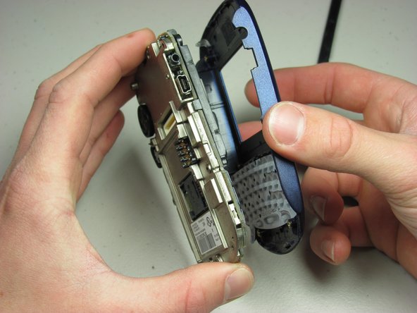

  6. BlackBerry 7510 Keypad Replacement, Keypad: crwdns2935265:06crwdnd2935265:01crwdnd2935265:03crwdne2935265:0 BlackBerry 7510 Keypad Replacement, Keypad: crwdns2935265:06crwdnd2935265:02crwdnd2935265:03crwdne2935265:0 BlackBerry 7510 Keypad Replacement, Keypad: crwdns2935265:06crwdnd2935265:03crwdnd2935265:03crwdne2935265:0
    • Unscrew metal plate.
    • Pry off front cover.
    • Lift off front cover to expose LCD screen.
  7. BlackBerry 7510 Keypad Replacement: crwdns2935265:07crwdnd2935265:01crwdnd2935265:01crwdne2935265:0
    • Remove keypad from front cover and replace or fix existing pad.
