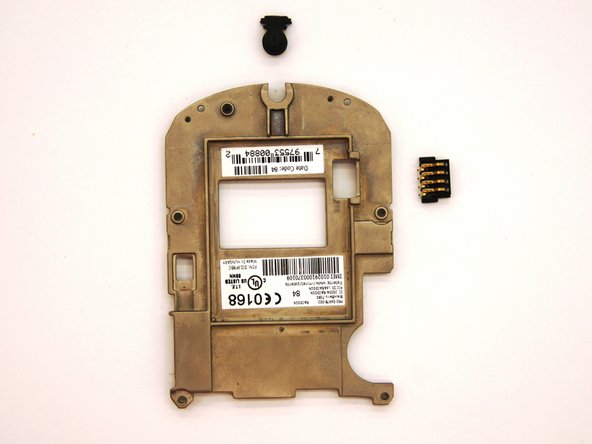

  11. BlackBerry 7280 Battery Connector Replacement, Battery Connector: crwdns2935265:011crwdnd2935265:01crwdnd2935265:02crwdne2935265:0 BlackBerry 7280 Battery Connector Replacement, Battery Connector: crwdns2935265:011crwdnd2935265:02crwdnd2935265:02crwdne2935265:0
    • To remove the battery connector simply slide it out from the metal bracket using your hand.
