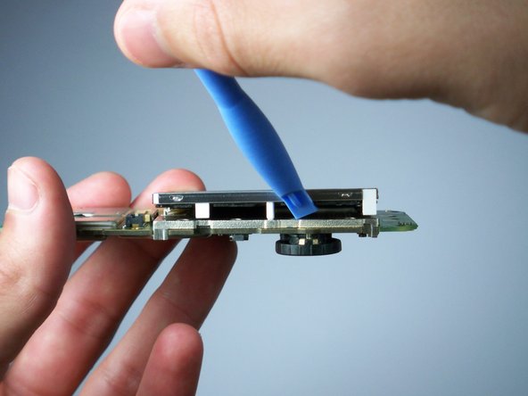

  16. BlackBerry 7130e LCD Replacement: crwdns2935265:016crwdnd2935265:01crwdnd2935265:02crwdne2935265:0 BlackBerry 7130e LCD Replacement: crwdns2935265:016crwdnd2935265:02crwdnd2935265:02crwdne2935265:0
    • Wedge the BlackBerry opening tool between the adhesive and LCD, twist upward so the LCD becomes loose.

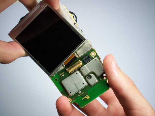

  17. BlackBerry 7130e LCD Replacement: crwdns2935265:017crwdnd2935265:01crwdnd2935265:02crwdne2935265:0 BlackBerry 7130e LCD Replacement: crwdns2935265:017crwdnd2935265:02crwdnd2935265:02crwdne2935265:0
    • The LCD should now be loose and only attached to the phone by the data wire.
    • Flip up the bar attached to the data wire with the BlackBerry opening tool, then the LCD data wire will slide out of the connector.
  18. BlackBerry 7130e LCD Replacement: crwdns2935265:018crwdnd2935265:01crwdnd2935265:01crwdne2935265:0
    • The LCD should easily separate from the phone at this point.
    • Put aside the old LCD and push the data wire of the new LCD into the area where the bar can secure it into place.
