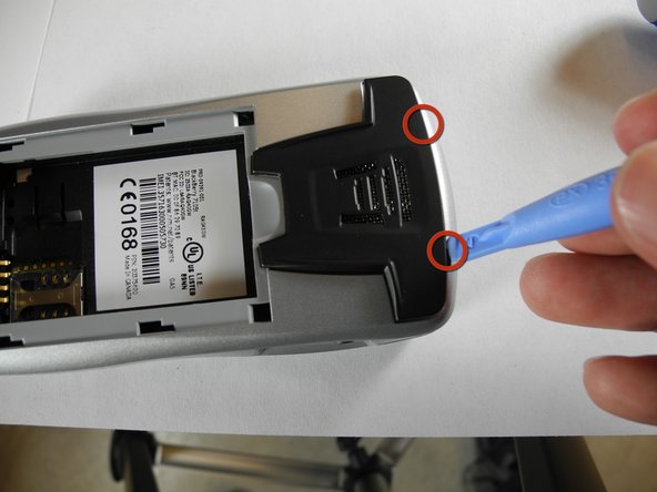

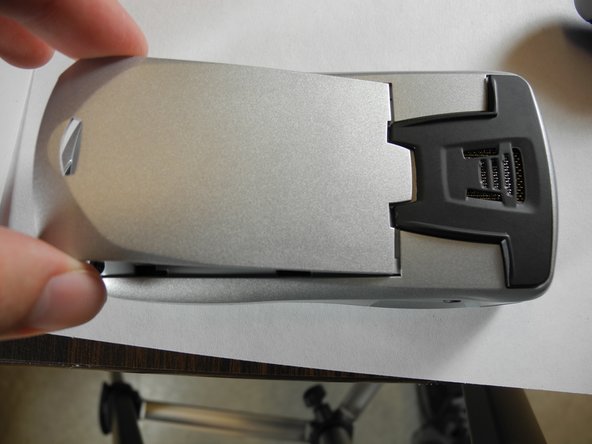

    • With the back of the device facing you, press down on the button while sliding the battery casing away from the speaker to remove it.
  2. BlackBerry 7105t LCD Replacement: crwdns2935265:02crwdnd2935265:01crwdnd2935265:01crwdne2935265:0
    • Use a plastic opening tool or fingernails to unclip the two hinges of the speaker covering and remove it.
  3. BlackBerry 7105t LCD Replacement: crwdns2935265:03crwdnd2935265:01crwdnd2935265:01crwdne2935265:0
    • Remove the battery by pushing against it from the right and then pulling towards you.

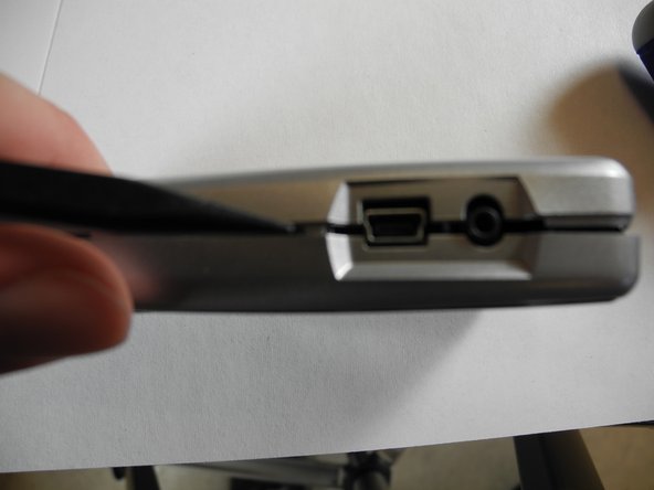

  5. BlackBerry 7105t LCD Replacement: crwdns2935265:05crwdnd2935265:01crwdnd2935265:03crwdne2935265:0 BlackBerry 7105t LCD Replacement: crwdns2935265:05crwdnd2935265:02crwdnd2935265:03crwdne2935265:0 BlackBerry 7105t LCD Replacement: crwdns2935265:05crwdnd2935265:03crwdnd2935265:03crwdne2935265:0
    • Use a plastic opening tool or your fingernails to remove the plastic backing.
    • Start with the seam indicated in the picture and slide the plastic opening tool until the case is seperated.

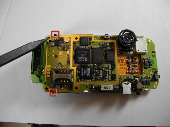

  9. BlackBerry 7105t LCD Replacement, LCD: crwdns2935265:09crwdnd2935265:01crwdnd2935265:01crwdne2935265:0
    • With the screen facing you, you will be able to see a small grey plastic clip.
    • Use a plastic opening tool to unfasten the clip as shown.
  10. BlackBerry 7105t LCD Replacement: crwdns2935265:010crwdnd2935265:01crwdnd2935265:02crwdne2935265:0 BlackBerry 7105t LCD Replacement: crwdns2935265:010crwdnd2935265:02crwdnd2935265:02crwdne2935265:0
    • Flip the logic board over to the other side.
    • Use a plastic opening tool unclip the top two clips shown in red, and then the bottom two clips. This releases the screen.
    • Flip logic board over and remove screen.
    • Make sure to hold the screen, it could fall after being unclipped.

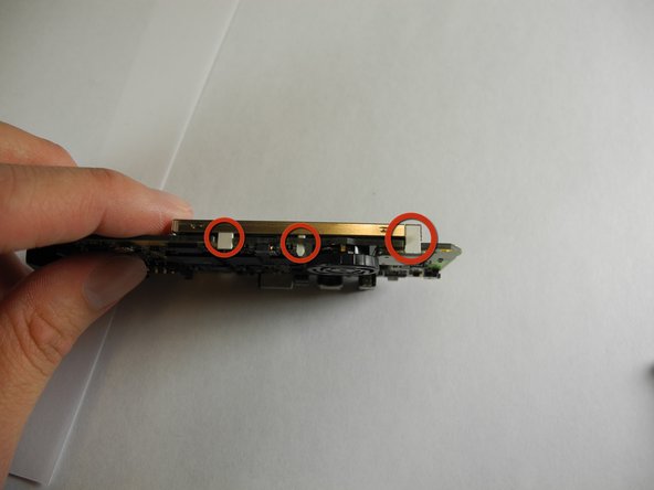

  13. BlackBerry 7105t LCD Replacement: crwdns2935265:013crwdnd2935265:01crwdnd2935265:02crwdne2935265:0 BlackBerry 7105t LCD Replacement: crwdns2935265:013crwdnd2935265:02crwdnd2935265:02crwdne2935265:0
    • Reattach Keyboard.
    • Flip phone over to the backside.
    • Make sure black clips on the back of the logic board click and are aligned.

  17. BlackBerry 7105t LCD Replacement: crwdns2935265:017crwdnd2935265:01crwdnd2935265:02crwdne2935265:0 BlackBerry 7105t LCD Replacement: crwdns2935265:017crwdnd2935265:02crwdnd2935265:02crwdne2935265:0
    • Reattach speaker covering as shown.
    • Using the Ipod opening tool, press the two clips on the top side of the speaker covering until they slip into the notch.
    • Warning: The clips are fragile, do not apply excessive force.

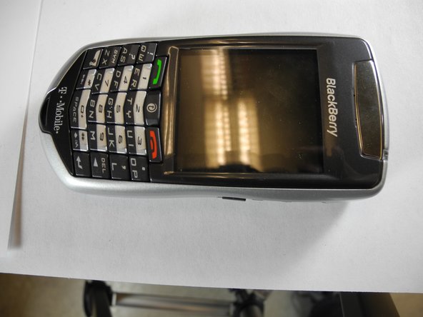

  18. BlackBerry 7105t LCD Replacement: crwdns2935265:018crwdnd2935265:01crwdnd2935265:03crwdne2935265:0 BlackBerry 7105t LCD Replacement: crwdns2935265:018crwdnd2935265:02crwdnd2935265:03crwdne2935265:0 BlackBerry 7105t LCD Replacement: crwdns2935265:018crwdnd2935265:03crwdnd2935265:03crwdne2935265:0
    • Insert Battery
    • Replace cover
