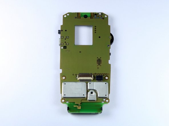

  14. BlackBerry 7100g Motherboard Replacement, Motherboard: crwdns2935265:014crwdnd2935265:01crwdnd2935265:02crwdne2935265:0 BlackBerry 7100g Motherboard Replacement, Motherboard: crwdns2935265:014crwdnd2935265:02crwdnd2935265:02crwdne2935265:0
    • You have successfully removed the motherboard.
