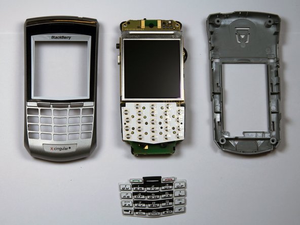

    • The keypad cover may fall out of the housing when prying the housing apart.
    • Tightly pinch the top of the front and back halves of the housing.
    • Carefully pry the two halves of the housing apart.
  7. BlackBerry 7100g Keypad Cover Replacement: crwdns2935265:07crwdnd2935265:01crwdnd2935265:01crwdne2935265:0
    • You can now easily remove the "guts" of the phone from the housing.
  8. BlackBerry 7100g Keypad Cover Replacement, Keypad Cover: crwdns2935265:08crwdnd2935265:01crwdnd2935265:02crwdne2935265:0 BlackBerry 7100g Keypad Cover Replacement, Keypad Cover: crwdns2935265:08crwdnd2935265:02crwdnd2935265:02crwdne2935265:0
    • Remove the keypad cover.
    • Insert the new keypad cover.
    • You are done replacing your keypad cover.
