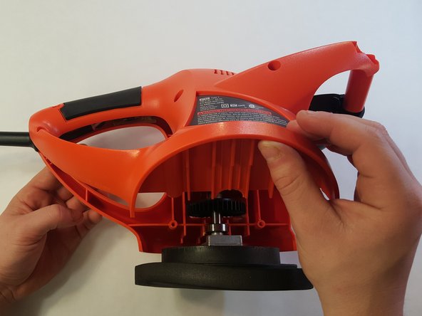

  2. Black and Decker WP900 Power Switch Replacement: crwdns2935265:02crwdnd2935265:01crwdnd2935265:01crwdne2935265:0
    • Using the Philips #1 screwdriver, unscrew all of the screws. There should be 8-30mm screws to remove.
    • Be sure to keep track of where each screw was placed in the device for later reassembly.
  3. Black and Decker WP900 Power Switch Replacement: crwdns2935265:03crwdnd2935265:01crwdnd2935265:03crwdne2935265:0 Black and Decker WP900 Power Switch Replacement: crwdns2935265:03crwdnd2935265:02crwdnd2935265:03crwdne2935265:0 Black and Decker WP900 Power Switch Replacement: crwdns2935265:03crwdnd2935265:03crwdnd2935265:03crwdne2935265:0

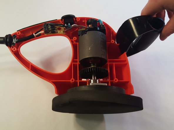

    • Remove the back panel of the external casing, leaving all internal components resting in the front panel.
    • Remove the black handle from the main external casing.

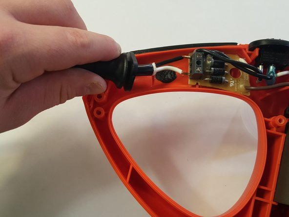

  4. Black and Decker WP900 Power Switch Replacement: crwdns2935265:04crwdnd2935265:01crwdnd2935265:01crwdne2935265:0
    • Loosen the power cord and control panel. Using the Phillip's #1 screwdriver, remove two 22mm screws.
    • The metal bracket will detach with the two screws.
    • Using the Flathead 3/32" screwdriver, remove two 22mm screws.
  5. Black and Decker WP900 Power Switch Replacement: crwdns2935265:05crwdnd2935265:01crwdnd2935265:02crwdne2935265:0 Black and Decker WP900 Power Switch Replacement: crwdns2935265:05crwdnd2935265:02crwdnd2935265:02crwdne2935265:0
    • Gently pull the power cord out from the control module.
    • Remember, when reassembling the device, the black wire should be on the top
  6. Black and Decker WP900 Power Switch Replacement: crwdns2935265:06crwdnd2935265:01crwdnd2935265:01crwdne2935265:0
    • Firmly grasping the motor, dislodge the internal components from the frontal external casing.
    • Switch and control panel will be attached to magnet body.
  7. Black and Decker WP900 Power Switch Replacement: crwdns2935265:07crwdnd2935265:01crwdnd2935265:01crwdne2935265:0
    • Remove the switch from the wires.
    • Gently, pull and release the two wired connections.
    • The switch can now be replaced. Be sure not to damage the two connections to the control module in the process.
