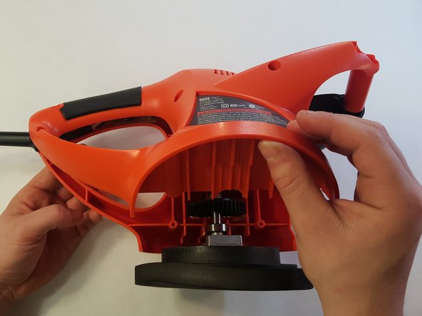

    • Using the plastic tool, detach the handle tab as shown.
    • Make sure the device is unplugged.
  2. Black and Decker WP900 Power Cord Replacement: crwdns2935265:02crwdnd2935265:01crwdnd2935265:01crwdne2935265:0
    • Using the Philips #1 screwdriver, unscrew all of the screws. There should be 8-30mm screws to remove.
    • Be sure to keep track of where each screw was placed in the device for later reassembly.
  3. Black and Decker WP900 Power Cord Replacement: crwdns2935265:03crwdnd2935265:01crwdnd2935265:03crwdne2935265:0 Black and Decker WP900 Power Cord Replacement: crwdns2935265:03crwdnd2935265:02crwdnd2935265:03crwdne2935265:0 Black and Decker WP900 Power Cord Replacement: crwdns2935265:03crwdnd2935265:03crwdnd2935265:03crwdne2935265:0
    • Remove the back panel of the external casing, leaving all internal components resting in the front panel.
    • Remove the black handle from the main external casing.

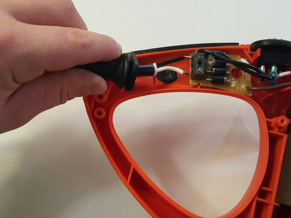

  4. Black and Decker WP900 Power Cord Replacement: crwdns2935265:04crwdnd2935265:01crwdnd2935265:01crwdne2935265:0
    • Loosen the power cord and control panel. Using the Phillips #1 screwdriver, remove two 22mm screws.
    • The metal bracket will detach with the two screws.
    • Using the Flathead 3/32" screwdriver, remove two 22mm screws.
  5. Black and Decker WP900 Power Cord Replacement: crwdns2935265:05crwdnd2935265:01crwdnd2935265:02crwdne2935265:0 Black and Decker WP900 Power Cord Replacement: crwdns2935265:05crwdnd2935265:02crwdnd2935265:02crwdne2935265:0
    • Gently pull the power cord out from the control module.
    • This is the part to be replaced. Remember to insert the black wire into the top port when installing the new cord.
