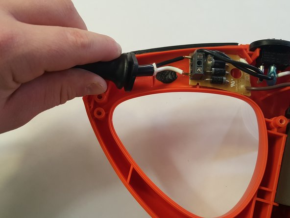

  5. Black and Decker WP900 Exterior Casing Replacement: crwdns2935265:05crwdnd2935265:01crwdnd2935265:02crwdne2935265:0 Black and Decker WP900 Exterior Casing Replacement: crwdns2935265:05crwdnd2935265:02crwdnd2935265:02crwdne2935265:0
    • Gently pull the power cord out from the control module.
    • Remember, when reassembling the device, the black wire should be on the top.
  6. Black and Decker WP900 Exterior Casing Replacement: crwdns2935265:06crwdnd2935265:01crwdnd2935265:01crwdne2935265:0
    • Firmly grasping the motor dislodge the internal components from the frontal external casing.
    • Once the motor has been removed, the external casing can now be replaced.
