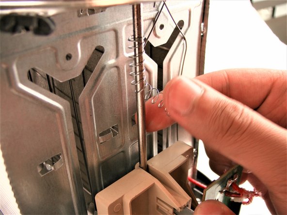

  6. Black and Decker TR1278B Lever Catch-Spring Replacement, Lever Catch Spring: crwdns2935265:06crwdnd2935265:01crwdnd2935265:01crwdne2935265:0
    • Lift the top cover up and remove it from the toaster.
  7. Black and Decker TR1278B Lever Catch-Spring Replacement: crwdns2935265:07crwdnd2935265:01crwdnd2935265:01crwdne2935265:0
    • Locate the springs.
    • There is a top spring and bottom spring.
  8. Black and Decker TR1278B Lever Catch-Spring Replacement: crwdns2935265:08crwdnd2935265:01crwdnd2935265:02crwdne2935265:0 Black and Decker TR1278B Lever Catch-Spring Replacement: crwdns2935265:08crwdnd2935265:02crwdnd2935265:02crwdne2935265:0
    • Use needle nose tweezers to free one end of the spring.
    • Turn the spring until it is completely free.
  9. Black and Decker TR1278B Lever Catch-Spring Replacement: crwdns2935265:09crwdnd2935265:01crwdnd2935265:01crwdne2935265:0
    • Remove spring for replacement.
    • Repeat steps for bottom spring.
