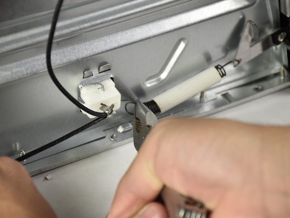

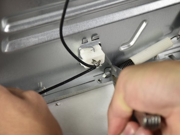

  6. Black and Decker TO1303SB Door Spring Removal/Replacement, Door Spring: crwdns2935265:06crwdnd2935265:01crwdnd2935265:03crwdne2935265:0 Black and Decker TO1303SB Door Spring Removal/Replacement, Door Spring: crwdns2935265:06crwdnd2935265:02crwdnd2935265:03crwdne2935265:0 Black and Decker TO1303SB Door Spring Removal/Replacement, Door Spring: crwdns2935265:06crwdnd2935265:03crwdnd2935265:03crwdne2935265:0
    • With the needle nose pliers, grasp the hook of the rear spring as close as you can to the coils. Stretch the spring back and, with a twisting motion, pull the hook out of its catch.
    • It is recommended to close the door before doing this.
    • Slowly relieve the tension after pulling it out of the catch or else it may damage the spring attachment.
  7. Black and Decker TO1303SB Door Spring Removal/Replacement: crwdns2935265:07crwdnd2935265:01crwdnd2935265:01crwdne2935265:0
    • Pull the front hook out of the spring attachment.
    • When replacing the spring, it is recommended to start by reattaching the hook onto the rear catch, then the front spring attachment. Attaching to the front spring attachment first will cause unnecessary stress to the attachment and may cause it to deform.
