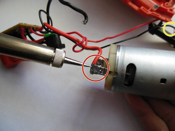

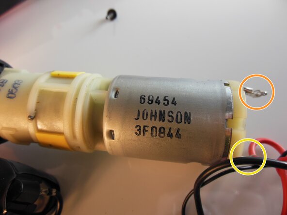

  4. Black and Decker Pivot Plus PD600 Motor Replacement: crwdns2935265:04crwdnd2935265:01crwdnd2935265:02crwdne2935265:0 Black and Decker Pivot Plus PD600 Motor Replacement: crwdns2935265:04crwdnd2935265:02crwdnd2935265:02crwdne2935265:0
    • After taking out the motor, you can observe two wires that are plugged in (or possibly soldered, depending on which variant you have) to the bottom of the motor. To detach the motor, unplug the wires or desolder their connections with a soldering iron as needed.
    • Mark or color code the black and red wires so you can return them to the correct position.
  5. Black and Decker Pivot Plus PD600 Motor Replacement: crwdns2935265:05crwdnd2935265:01crwdnd2935265:01crwdne2935265:0
    • Wait for the wires and connectors to cool. Pull the wires from the motor and the motor should now be fully disconnected from the drill.
