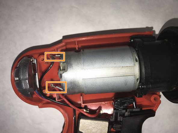

  3. Black and Decker PS1800 Transmission Replacement, Disconnect Motor: crwdns2935265:03crwdnd2935265:01crwdnd2935265:03crwdne2935265:0 Black and Decker PS1800 Transmission Replacement, Disconnect Motor: crwdns2935265:03crwdnd2935265:02crwdnd2935265:03crwdne2935265:0 Black and Decker PS1800 Transmission Replacement, Disconnect Motor: crwdns2935265:03crwdnd2935265:03crwdnd2935265:03crwdne2935265:0
    • Locate the motor at the top left hand corner.
    • Carefully disconnect the red and black wires attached to the motor.
