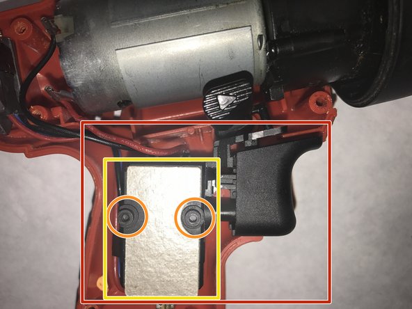

  3. Black and Decker PS1800  Switch Replacement, Switch: crwdns2935265:03crwdnd2935265:01crwdnd2935265:02crwdne2935265:0 Black and Decker PS1800  Switch Replacement, Switch: crwdns2935265:03crwdnd2935265:02crwdnd2935265:02crwdne2935265:0
    • Identify the switch in center of the drill.
    • Remove the screws from the switch.
    • Remove the switch cover.
  4. Black and Decker PS1800  Switch Replacement: crwdns2935265:04crwdnd2935265:01crwdnd2935265:01crwdne2935265:0
    • Locate the switch inside the drill.
    • Remove the switch from the drill.

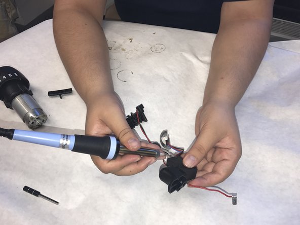

  5. Black and Decker PS1800  Switch Replacement: crwdns2935265:05crwdnd2935265:01crwdnd2935265:02crwdne2935265:0 Black and Decker PS1800  Switch Replacement: crwdns2935265:05crwdnd2935265:02crwdnd2935265:02crwdne2935265:0
    • Solder off all the joints.
    • Remove the switch assembly.
