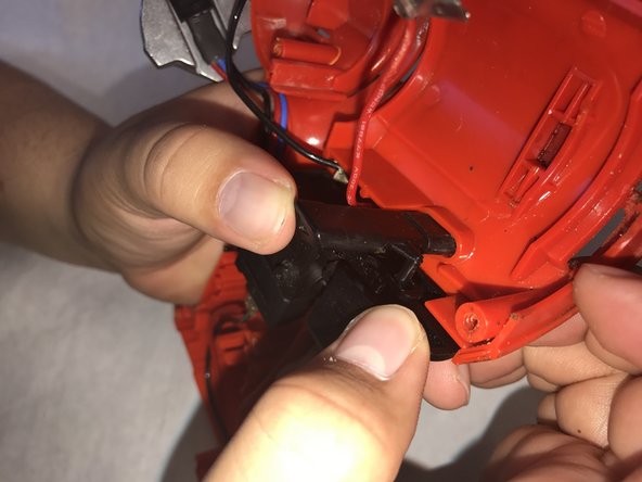

    • Start separating the outer shell into two parts.

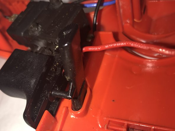

    • You will find the Fwd/Rev actuator on the right side of the drill, underneath the motor.
  4. Black and Decker PS1800  Actuator Fwd/Rev Replacement: crwdns2935265:04crwdnd2935265:01crwdnd2935265:03crwdne2935265:0 Black and Decker PS1800  Actuator Fwd/Rev Replacement: crwdns2935265:04crwdnd2935265:02crwdnd2935265:03crwdne2935265:0 Black and Decker PS1800  Actuator Fwd/Rev Replacement: crwdns2935265:04crwdnd2935265:03crwdnd2935265:03crwdne2935265:0
    • Carefully remove the actuator from the drill.
    • Replace the new actuator by inserting it the same way you took it out.
