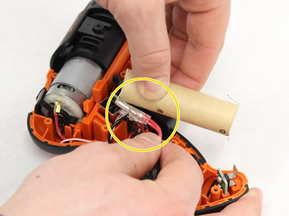

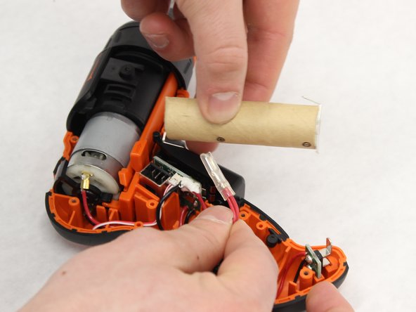

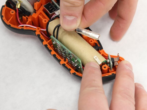

    • Gently pull up on the end of the battery closest to the negative terminal. Pulling the battery up should reveal the positive (red) wire located on the opposite end of the battery.
    • To free battery, gently pull back on the positive (red) wire.

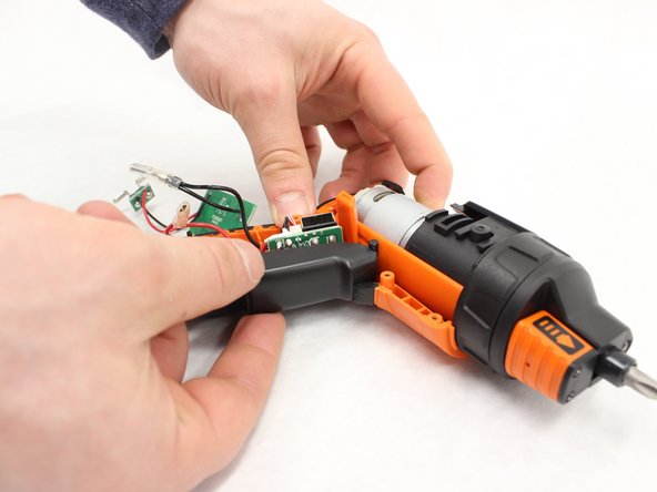

    • Be sure to inspect trigger contacts before moving on to this step.
    • To remove the trigger/switch board, gently pull the board directly up - away from casing.

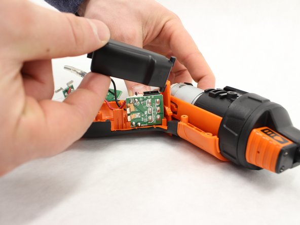

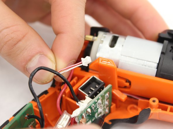

    • Locate the plug wire with red and white wires leading the trigger/switch board.
    • Remove the plug wire from the trigger/switch board by gently pulling back on wire.

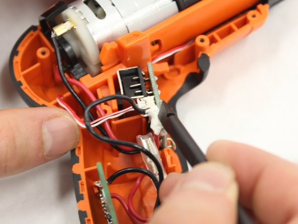

  11. Black and Decker LI4000 Trigger/Switch Board Replacement: crwdns2935265:011crwdnd2935265:01crwdnd2935265:03crwdne2935265:0 Black and Decker LI4000 Trigger/Switch Board Replacement: crwdns2935265:011crwdnd2935265:02crwdnd2935265:03crwdne2935265:0 Black and Decker LI4000 Trigger/Switch Board Replacement: crwdns2935265:011crwdnd2935265:03crwdnd2935265:03crwdne2935265:0
    • The white adhesive will need to be removed with a plastic spudger.
    • Gently scrape away all of the white adhesive until wires are fully exposed on the trigger/switch board.

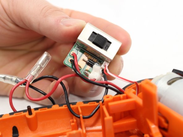

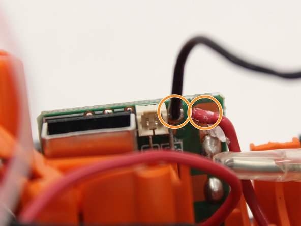

  12. Black and Decker LI4000 Trigger/Switch Board Replacement: crwdns2935265:012crwdnd2935265:01crwdnd2935265:01crwdne2935265:0
    • To replace trigger/switch board, use a soldering iron to remove the four soldering joints shown.
    • iFixit has a quick tutorial on soldering here
