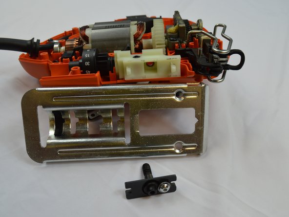

    • Unscrew the eight screws to open up the jigsaw.
  2. Black and Decker JS660 Angle Knob Replacement: crwdns2935265:02crwdnd2935265:01crwdnd2935265:01crwdne2935265:0
    • Use a screwdriver to remove the first screws securing the base to the jigsaw.
    • Remove the second screw.
    • Remove the base of the jigsaw.
  3. Black and Decker JS660 Angle Knob Replacement: crwdns2935265:03crwdnd2935265:01crwdnd2935265:02crwdne2935265:0 Black and Decker JS660 Angle Knob Replacement: crwdns2935265:03crwdnd2935265:02crwdnd2935265:02crwdne2935265:0
    • With the old jigsaw base off, replace it with the new base by following the steps in the reverse order.
    • Assemble the base on a steady surface.

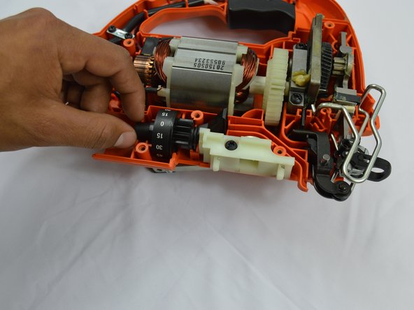

  4. Black and Decker JS660 Angle Knob Replacement, Angle Knob: crwdns2935265:04crwdnd2935265:01crwdnd2935265:03crwdne2935265:0 Black and Decker JS660 Angle Knob Replacement, Angle Knob: crwdns2935265:04crwdnd2935265:02crwdnd2935265:03crwdne2935265:0 Black and Decker JS660 Angle Knob Replacement, Angle Knob: crwdns2935265:04crwdnd2935265:03crwdnd2935265:03crwdne2935265:0
    • As soon you disassemble the device, you can see the angle knob is not attached to any screws.
    • Remove the angle knob from the device.
