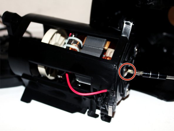

    • Lay the juicer horizontally and roll the top shaft cover until it comes off.
  5. Black and Decker JE2200B Motor Compartment Replacement: crwdns2935265:05crwdnd2935265:01crwdnd2935265:01crwdne2935265:0
    • Unscrew the 19.1 mm screws inside the juicer holding the motor compartment attached to the juicer. Use the 2.5 mm Flathead adapter as the screw driver. The diameter of the screw head is 7.1 mm.

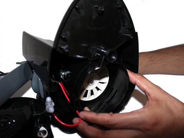

  6. Black and Decker JE2200B Motor Compartment Replacement: crwdns2935265:06crwdnd2935265:01crwdnd2935265:03crwdne2935265:0 Black and Decker JE2200B Motor Compartment Replacement: crwdns2935265:06crwdnd2935265:02crwdnd2935265:03crwdne2935265:0 Black and Decker JE2200B Motor Compartment Replacement: crwdns2935265:06crwdnd2935265:03crwdnd2935265:03crwdne2935265:0
    • Remove the motor compartment from the juicer and it is ready to be replaced.
