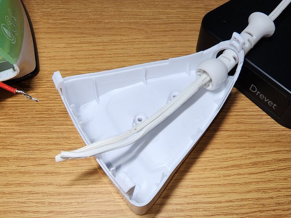

  3. Black and Decker IR02V-T Power Cord Replacement: crwdns2935265:03crwdnd2935265:01crwdnd2935265:03crwdne2935265:0 Black and Decker IR02V-T Power Cord Replacement: crwdns2935265:03crwdnd2935265:02crwdnd2935265:03crwdne2935265:0 Black and Decker IR02V-T Power Cord Replacement: crwdns2935265:03crwdnd2935265:03crwdnd2935265:03crwdne2935265:0
    • Remove the old power cord from the iron completely.
    • Insert the new cord through the plastic cover and hole of the iron as demonstrated in the image.
  4. Black and Decker IR02V-T Power Cord Replacement: crwdns2935265:04crwdnd2935265:01crwdnd2935265:03crwdne2935265:0 Black and Decker IR02V-T Power Cord Replacement: crwdns2935265:04crwdnd2935265:02crwdnd2935265:03crwdne2935265:0 Black and Decker IR02V-T Power Cord Replacement: crwdns2935265:04crwdnd2935265:03crwdnd2935265:03crwdne2935265:0
    • Expose about half an inch of wire by removing the silicone that encases it.
    • Tie the new wire into a knot and connect the wires accordingly.
    • Place the caps over the exposed wire and use pliers to tighten the metal to secure the wire.
  5. Black and Decker IR02V-T Power Cord Replacement: crwdns2935265:05crwdnd2935265:01crwdnd2935265:03crwdne2935265:0 Black and Decker IR02V-T Power Cord Replacement: crwdns2935265:05crwdnd2935265:02crwdnd2935265:03crwdne2935265:0 Black and Decker IR02V-T Power Cord Replacement: crwdns2935265:05crwdnd2935265:03crwdnd2935265:03crwdne2935265:0
    • Once the caps are over the wires add the two 1 mm Phillips screws along with the small base plate which secures the wire.
    • When all wires are secure place the plastic cover and screw back in the 1mm Torx screws.
