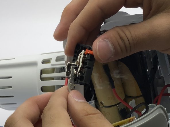

  6. Black and Decker Dustbuster CHV1510 Power Button Assembly Replacement, Power Button Assembly: crwdns2935265:06crwdnd2935265:01crwdnd2935265:03crwdne2935265:0 Black and Decker Dustbuster CHV1510 Power Button Assembly Replacement, Power Button Assembly: crwdns2935265:06crwdnd2935265:02crwdnd2935265:03crwdne2935265:0 Black and Decker Dustbuster CHV1510 Power Button Assembly Replacement, Power Button Assembly: crwdns2935265:06crwdnd2935265:03crwdnd2935265:03crwdne2935265:0
    • Open the black assembly by prying the two halves apart with an opening tool.
    • Note which wire connects to each tab to avoid confusion later.

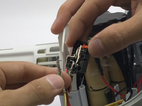

  7. Black and Decker Dustbuster CHV1510 Power Button Assembly Replacement: crwdns2935265:07crwdnd2935265:01crwdnd2935265:02crwdne2935265:0 Black and Decker Dustbuster CHV1510 Power Button Assembly Replacement: crwdns2935265:07crwdnd2935265:02crwdnd2935265:02crwdne2935265:0
    • Gently pull the yellow wire on the right out of the assembly for removal.
  8. Black and Decker Dustbuster CHV1510 Power Button Assembly Replacement: crwdns2935265:08crwdnd2935265:01crwdnd2935265:03crwdne2935265:0 Black and Decker Dustbuster CHV1510 Power Button Assembly Replacement: crwdns2935265:08crwdnd2935265:02crwdnd2935265:03crwdne2935265:0 Black and Decker Dustbuster CHV1510 Power Button Assembly Replacement: crwdns2935265:08crwdnd2935265:03crwdnd2935265:03crwdne2935265:0
    • Gently pull the red wire with the black wire casing in the middle out of the assembly for removal.
  9. Black and Decker Dustbuster CHV1510 Power Button Assembly Replacement: crwdns2935265:09crwdnd2935265:01crwdnd2935265:02crwdne2935265:0 Black and Decker Dustbuster CHV1510 Power Button Assembly Replacement: crwdns2935265:09crwdnd2935265:02crwdnd2935265:02crwdne2935265:0
    • Gently pull the red wire on the left out of the assembly for removal.
To reassemble this device, follow these instructions in reverse order. Make sure you keep track of which wire belongs to which flat metal assembly tab, to ensure each wire is grounded so power is connected properly.
