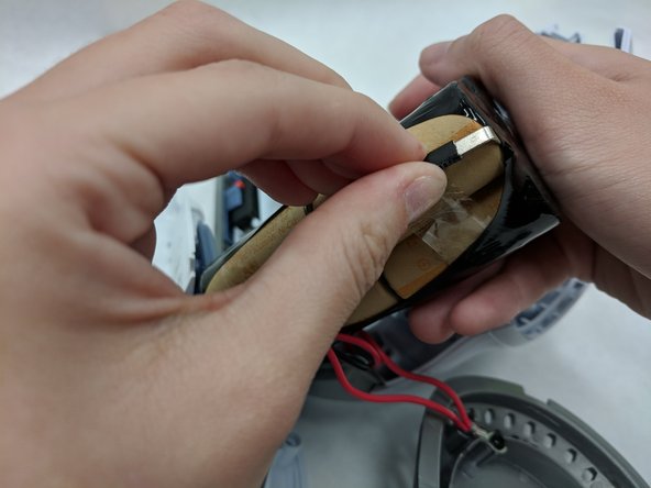

    • Removal of the battery pack is a tool-less process, lift the battery pack out of the vacuum gently, notice there are two wires connected to the battery.
  6. Black and Decker Dustbuster CHV1510 Battery Pack Replacement: crwdns2935265:06crwdnd2935265:01crwdnd2935265:02crwdne2935265:0 Black and Decker Dustbuster CHV1510 Battery Pack Replacement: crwdns2935265:06crwdnd2935265:02crwdnd2935265:02crwdne2935265:0
    • Disconnect the red wire from the battery pack (pull do not twist!) and do the same with the black wire
  7. Black and Decker Dustbuster CHV1510 Battery Pack Replacement, Battery Pack: crwdns2935265:07crwdnd2935265:01crwdnd2935265:03crwdne2935265:0 Black and Decker Dustbuster CHV1510 Battery Pack Replacement, Battery Pack: crwdns2935265:07crwdnd2935265:02crwdnd2935265:03crwdne2935265:0 Black and Decker Dustbuster CHV1510 Battery Pack Replacement, Battery Pack: crwdns2935265:07crwdnd2935265:03crwdnd2935265:03crwdne2935265:0
    • Holding the battery pack firmly, disconnect the red and black wires from the battery pack by pulling them gently.
