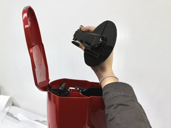

    • Using the jimmy, pry the shower head out of place
  3. Black and Decker DCM100R Reservoir Tube Replacement: crwdns2935265:03crwdnd2935265:01crwdnd2935265:03crwdne2935265:0 Black and Decker DCM100R Reservoir Tube Replacement: crwdns2935265:03crwdnd2935265:02crwdnd2935265:03crwdne2935265:0 Black and Decker DCM100R Reservoir Tube Replacement: crwdns2935265:03crwdnd2935265:03crwdnd2935265:03crwdne2935265:0
    • Turn the shower head 90 degrees and remove it.

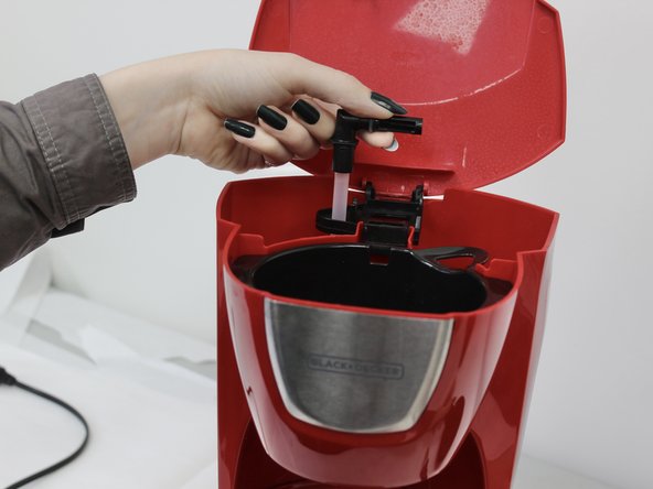

  4. Black and Decker DCM100R Reservoir Tube Replacement, Reservoir Tube: crwdns2935265:04crwdnd2935265:01crwdnd2935265:02crwdne2935265:0 Black and Decker DCM100R Reservoir Tube Replacement, Reservoir Tube: crwdns2935265:04crwdnd2935265:02crwdnd2935265:02crwdne2935265:0
    • Remove the hinge containing the reservoir tube.
  5. Black and Decker DCM100R Reservoir Tube Replacement: crwdns2935265:05crwdnd2935265:01crwdnd2935265:02crwdne2935265:0 Black and Decker DCM100R Reservoir Tube Replacement: crwdns2935265:05crwdnd2935265:02crwdnd2935265:02crwdne2935265:0

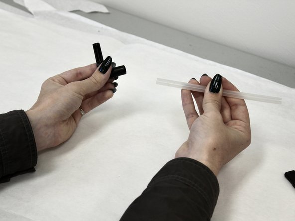

    • Pull out and replace the reservoir tube.
