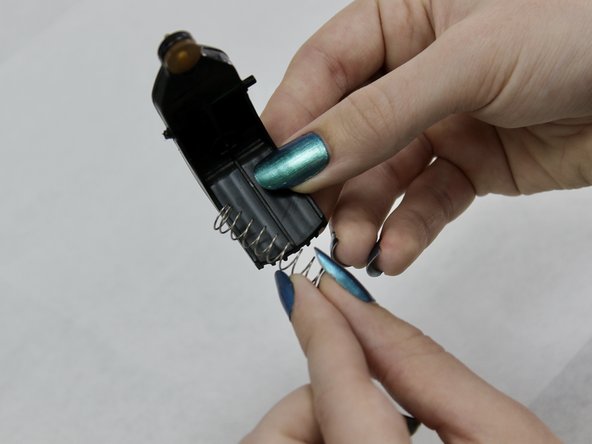

Black and Decker DCM100R Lever Spring Replacement
  1. Black and Decker DCM100R Lever Spring Replacement, Filter Basket Lever Spring: crwdns2935265:01crwdnd2935265:01crwdnd2935265:01crwdne2935265:0
    • Open the lid.
  2. Black and Decker DCM100R Lever Spring Replacement: crwdns2935265:02crwdnd2935265:01crwdnd2935265:01crwdne2935265:0
    • Remove the filter basket.
  3. Black and Decker DCM100R Lever Spring Replacement: crwdns2935265:03crwdnd2935265:01crwdnd2935265:02crwdne2935265:0 Black and Decker DCM100R Lever Spring Replacement: crwdns2935265:03crwdnd2935265:02crwdnd2935265:02crwdne2935265:0
    • Use a metal spudger to pry the filter basket lever off of the filter basket.
  4. Black and Decker DCM100R Lever Spring Replacement: crwdns2935265:04crwdnd2935265:01crwdnd2935265:02crwdne2935265:0 Black and Decker DCM100R Lever Spring Replacement: crwdns2935265:04crwdnd2935265:02crwdnd2935265:02crwdne2935265:0
    • Remove and replace the malfunctioning spring.
