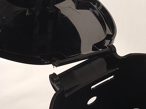

    • Open the lid of the coffee maker.
    • Remove the brew cup.
  2. Black and Decker CM0700BZ Water Tank Replacement: crwdns2935265:02crwdnd2935265:01crwdnd2935265:03crwdne2935265:0 Black and Decker CM0700BZ Water Tank Replacement: crwdns2935265:02crwdnd2935265:02crwdnd2935265:03crwdne2935265:0 Black and Decker CM0700BZ Water Tank Replacement: crwdns2935265:02crwdnd2935265:03crwdnd2935265:03crwdne2935265:0
    • Place your finger, screwdriver, or spudger behind the corner of the tab.
    • Pull up on the tab until it disconnects from the coffee maker.
  3. Black and Decker CM0700BZ Water Tank Replacement: crwdns2935265:03crwdnd2935265:01crwdnd2935265:03crwdne2935265:0 Black and Decker CM0700BZ Water Tank Replacement: crwdns2935265:03crwdnd2935265:02crwdnd2935265:03crwdne2935265:0 Black and Decker CM0700BZ Water Tank Replacement: crwdns2935265:03crwdnd2935265:03crwdnd2935265:03crwdne2935265:0
    • Hold the tab while pushing back on the lid.
    • The lid should open fully with the top of the lid facing down.
  4. Black and Decker CM0700BZ Water Tank Replacement: crwdns2935265:04crwdnd2935265:01crwdnd2935265:02crwdne2935265:0 Black and Decker CM0700BZ Water Tank Replacement: crwdns2935265:04crwdnd2935265:02crwdnd2935265:02crwdne2935265:0
    • Insert the flathead screwdriver or spudger into one of the inserts holding the lid.
    • Pry facing away from the lid to force the peg out.
    • You should hear a pop when it disconnects.
    • Hold the lid and pull it away from the other insert.
  5. Black and Decker CM0700BZ Water Tank Replacement: crwdns2935265:05crwdnd2935265:01crwdnd2935265:01crwdne2935265:0
    • To also remove the shower head, use the Shower Head guide.

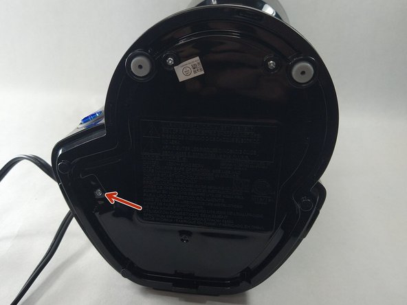

    • Remove the carafe holder from the bottom of the coffee machine.
  7. Black and Decker CM0700BZ Water Tank Replacement: crwdns2935265:07crwdnd2935265:01crwdnd2935265:03crwdne2935265:0 Black and Decker CM0700BZ Water Tank Replacement: crwdns2935265:07crwdnd2935265:02crwdnd2935265:03crwdne2935265:0 Black and Decker CM0700BZ Water Tank Replacement: crwdns2935265:07crwdnd2935265:03crwdnd2935265:03crwdne2935265:0
    • Place coffee maker on its side, with the bottom facing you.
    • Remove two 10mm Phillips #1 screws and one 10mm Tri-Point Y1 screws with their designated tips.
  8. Black and Decker CM0700BZ Water Tank Replacement: crwdns2935265:08crwdnd2935265:01crwdnd2935265:03crwdne2935265:0 Black and Decker CM0700BZ Water Tank Replacement: crwdns2935265:08crwdnd2935265:02crwdnd2935265:03crwdne2935265:0 Black and Decker CM0700BZ Water Tank Replacement: crwdns2935265:08crwdnd2935265:03crwdnd2935265:03crwdne2935265:0
    • Slowly pry the bottom lid from the front.
    • You should hear a pop.
    • Pull up and remove the bottom lid.
