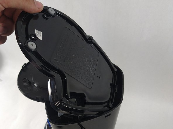

    • Open the lid of the coffee maker.
    • Remove the brew cup.
  2. Black and Decker CM0700BZ Water Piping Replacement: crwdns2935265:02crwdnd2935265:01crwdnd2935265:03crwdne2935265:0 Black and Decker CM0700BZ Water Piping Replacement: crwdns2935265:02crwdnd2935265:02crwdnd2935265:03crwdne2935265:0 Black and Decker CM0700BZ Water Piping Replacement: crwdns2935265:02crwdnd2935265:03crwdnd2935265:03crwdne2935265:0
    • Place your finger, screwdriver, or spudger behind the corner of the tab.
    • Pull up on the tab until it disconnects from the coffee maker.
  3. Black and Decker CM0700BZ Water Piping Replacement: crwdns2935265:03crwdnd2935265:01crwdnd2935265:03crwdne2935265:0 Black and Decker CM0700BZ Water Piping Replacement: crwdns2935265:03crwdnd2935265:02crwdnd2935265:03crwdne2935265:0 Black and Decker CM0700BZ Water Piping Replacement: crwdns2935265:03crwdnd2935265:03crwdnd2935265:03crwdne2935265:0
    • Hold the tab while pushing back on the lid.
    • The lid should open fully with the top of the lid facing down.
  4. Black and Decker CM0700BZ Water Piping Replacement: crwdns2935265:04crwdnd2935265:01crwdnd2935265:02crwdne2935265:0 Black and Decker CM0700BZ Water Piping Replacement: crwdns2935265:04crwdnd2935265:02crwdnd2935265:02crwdne2935265:0
    • Insert the flathead screwdriver or spudger into one of the inserts holding the lid.
    • Pry facing away from the lid to force the peg out.
    • You should hear a pop when it disconnects.
    • Hold the lid and pull it away from the other insert.

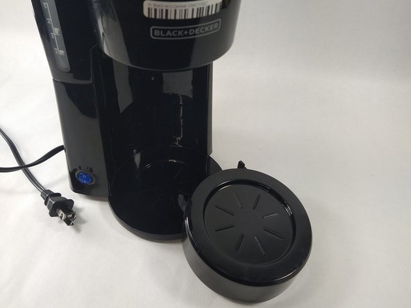

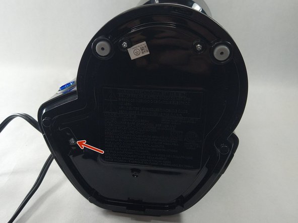

    • Remove the carafe holder from the bottom of the coffee machine.

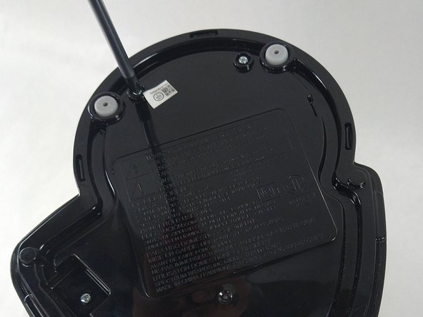

  7. Black and Decker CM0700BZ Water Piping Replacement: crwdns2935265:07crwdnd2935265:01crwdnd2935265:03crwdne2935265:0 Black and Decker CM0700BZ Water Piping Replacement: crwdns2935265:07crwdnd2935265:02crwdnd2935265:03crwdne2935265:0 Black and Decker CM0700BZ Water Piping Replacement: crwdns2935265:07crwdnd2935265:03crwdnd2935265:03crwdne2935265:0

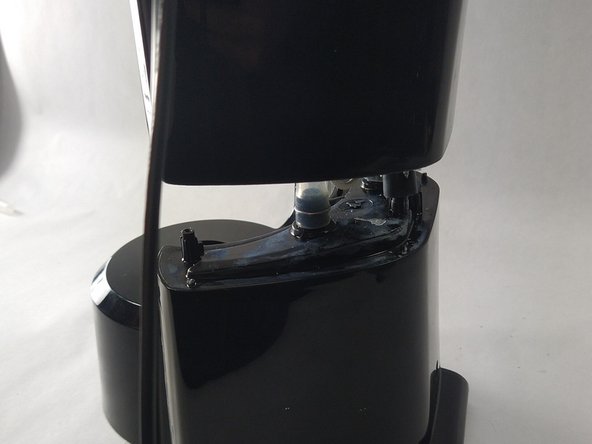

    • Place coffee maker on its side, with the bottom facing you.
    • Remove two 10mm Phillips #1 screws and one 10mm Tri-Point Y1 screws with their designated tips.
  8. Black and Decker CM0700BZ Water Piping Replacement: crwdns2935265:08crwdnd2935265:01crwdnd2935265:03crwdne2935265:0 Black and Decker CM0700BZ Water Piping Replacement: crwdns2935265:08crwdnd2935265:02crwdnd2935265:03crwdne2935265:0 Black and Decker CM0700BZ Water Piping Replacement: crwdns2935265:08crwdnd2935265:03crwdnd2935265:03crwdne2935265:0
    • Slowly pry bottom lid from the front.
    • You should hear a pop.
    • Pull up and remove the bottom lid and set aside.

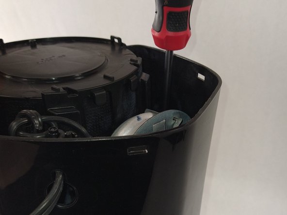

  9. Black and Decker CM0700BZ Water Piping Replacement: crwdns2935265:09crwdnd2935265:01crwdnd2935265:01crwdne2935265:0
    • Follow Step #4 of the Power Button guide, but leave the button in the machine.

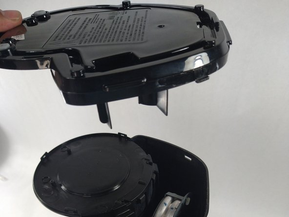

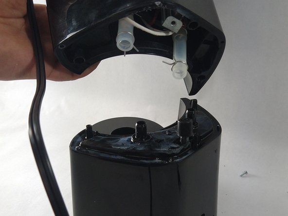

  10. Black and Decker CM0700BZ Water Piping Replacement: crwdns2935265:010crwdnd2935265:01crwdnd2935265:03crwdne2935265:0 Black and Decker CM0700BZ Water Piping Replacement: crwdns2935265:010crwdnd2935265:02crwdnd2935265:03crwdne2935265:0 Black and Decker CM0700BZ Water Piping Replacement: crwdns2935265:010crwdnd2935265:03crwdnd2935265:03crwdne2935265:0
    • Remove the four 10mm Phillips #1 screws.
    • Slowly pull the water tank up to expose the water pipes.

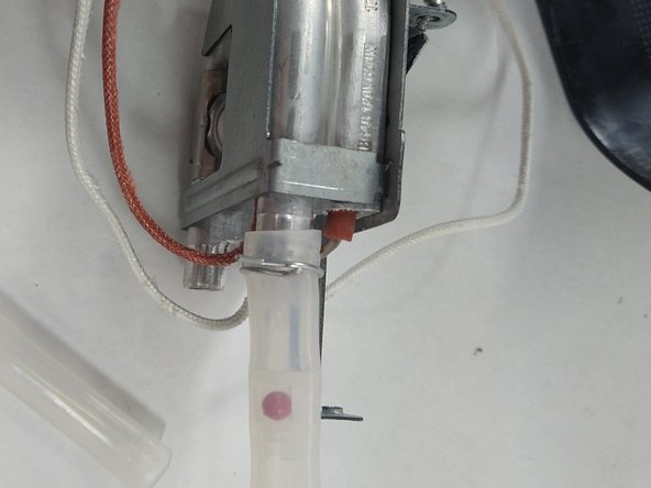

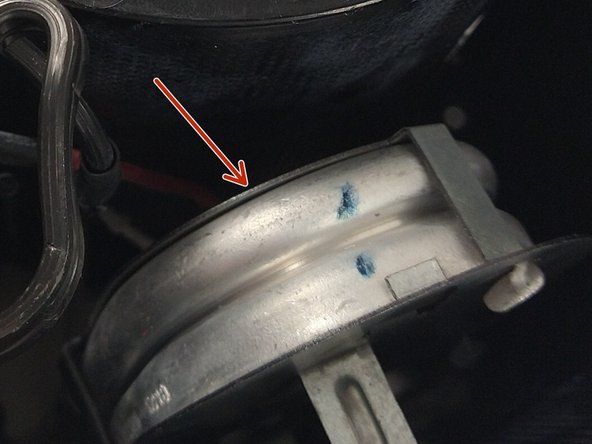

  11. Black and Decker CM0700BZ Water Piping Replacement: crwdns2935265:011crwdnd2935265:01crwdnd2935265:03crwdne2935265:0 Black and Decker CM0700BZ Water Piping Replacement: crwdns2935265:011crwdnd2935265:02crwdnd2935265:03crwdne2935265:0 Black and Decker CM0700BZ Water Piping Replacement: crwdns2935265:011crwdnd2935265:03crwdnd2935265:03crwdne2935265:0
    • Squeeze on the prongs with tweezers and hold.
    • Pull the water tank while squeezing the tighteners to loosen the water pipes off of the water tank.
    • The heating element should now be loose. Remove the heating element from the machine.
  12. Black and Decker CM0700BZ Water Piping Replacement: crwdns2935265:012crwdnd2935265:01crwdnd2935265:02crwdne2935265:0 Black and Decker CM0700BZ Water Piping Replacement: crwdns2935265:012crwdnd2935265:02crwdnd2935265:02crwdne2935265:0
    • Squeeze and hold with tweezers again.
    • Pull the water tubes off the heating element while squeezing with tweezers.
