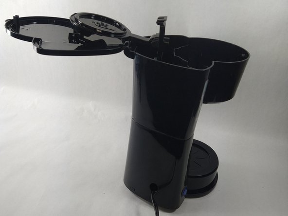

    • Open the lid of the coffee maker.
    • Remove the brew cup.

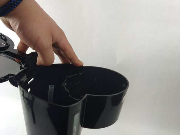

  2. Black and Decker CM0700BZ Shower Head Replacement: crwdns2935265:02crwdnd2935265:01crwdnd2935265:03crwdne2935265:0 Black and Decker CM0700BZ Shower Head Replacement: crwdns2935265:02crwdnd2935265:02crwdnd2935265:03crwdne2935265:0 Black and Decker CM0700BZ Shower Head Replacement: crwdns2935265:02crwdnd2935265:03crwdnd2935265:03crwdne2935265:0
    • Place your finger, a screwdriver, or a spudger behind the corner of the tab.
    • Pull up on the tab until it disconnects from the coffee maker.
  3. Black and Decker CM0700BZ Shower Head Replacement: crwdns2935265:03crwdnd2935265:01crwdnd2935265:03crwdne2935265:0 Black and Decker CM0700BZ Shower Head Replacement: crwdns2935265:03crwdnd2935265:02crwdnd2935265:03crwdne2935265:0 Black and Decker CM0700BZ Shower Head Replacement: crwdns2935265:03crwdnd2935265:03crwdnd2935265:03crwdne2935265:0
    • Push the lid while holding the tab.
    • The lid should open fully with the top of the lid facing down.

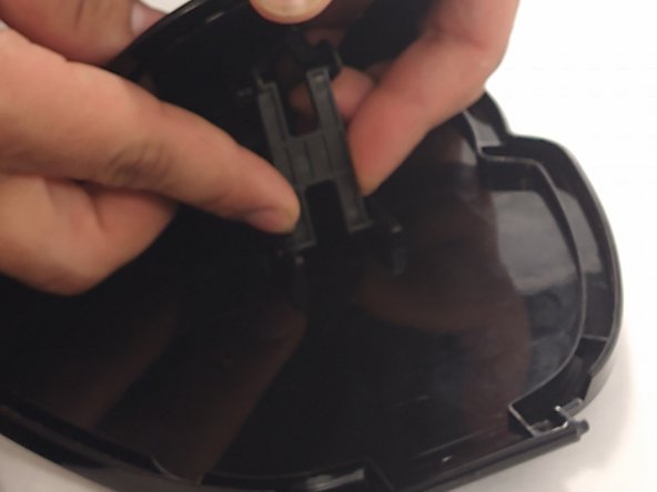

  4. Black and Decker CM0700BZ Shower Head Replacement: crwdns2935265:04crwdnd2935265:01crwdnd2935265:02crwdne2935265:0 Black and Decker CM0700BZ Shower Head Replacement: crwdns2935265:04crwdnd2935265:02crwdnd2935265:02crwdne2935265:0
    • Lift up the shower head while the lid is lying flat.
    • Squeeze the tabs together until one peg comes loose from the insert.
    • Pull the other peg from the insert and remove the shower head from the lid.
