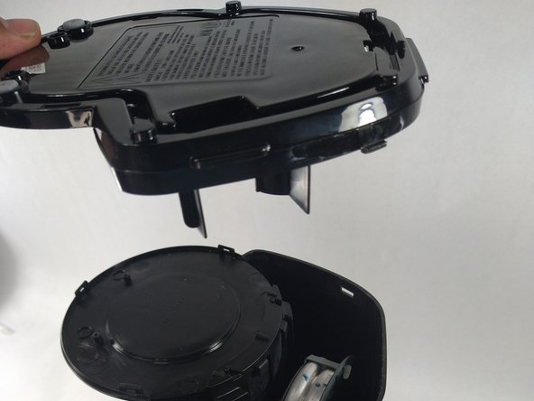

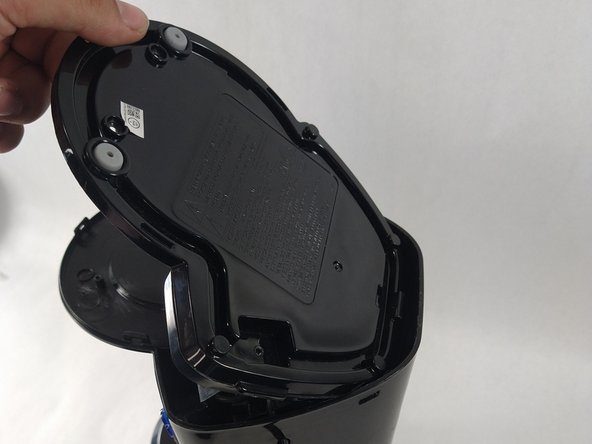

    • Slowly pry the bottom lid from the front.
    • You should hear a pop.
    • Pull up and remove the bottom lid.

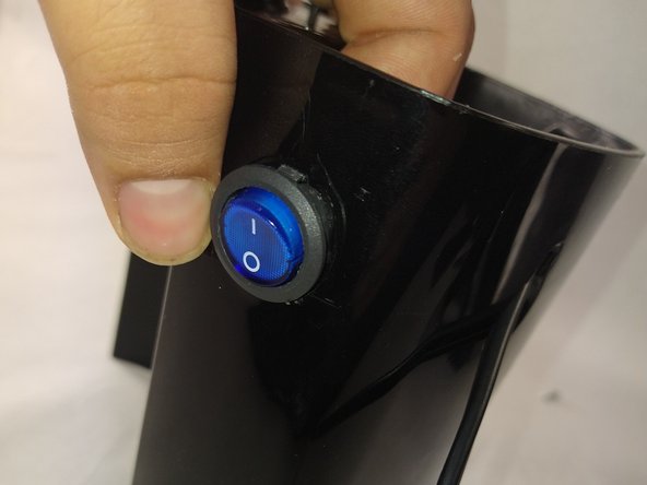

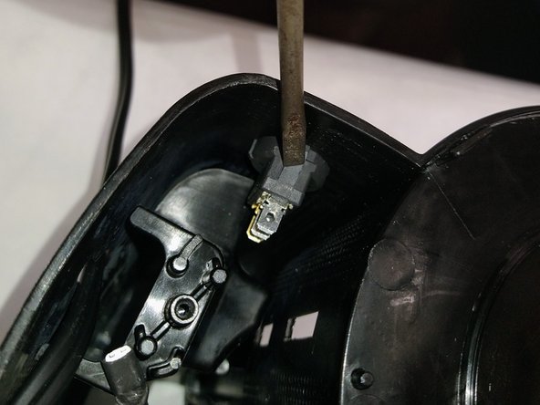

    • Using a screwdriver or spudger, firmly press on the middle of heat shrink and pull each electrical connection apart.

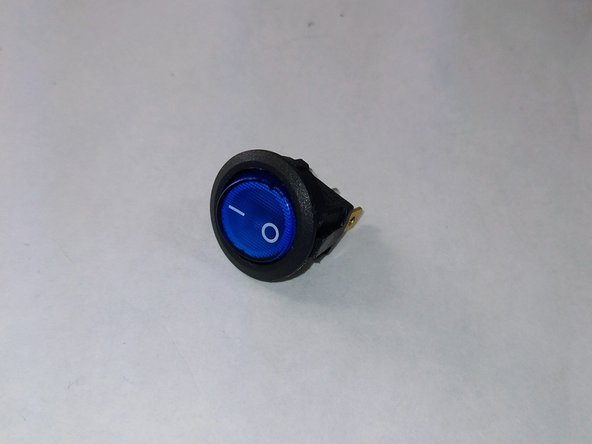

    • Gently push the power button out of the housing while pushing the tabs inwards.

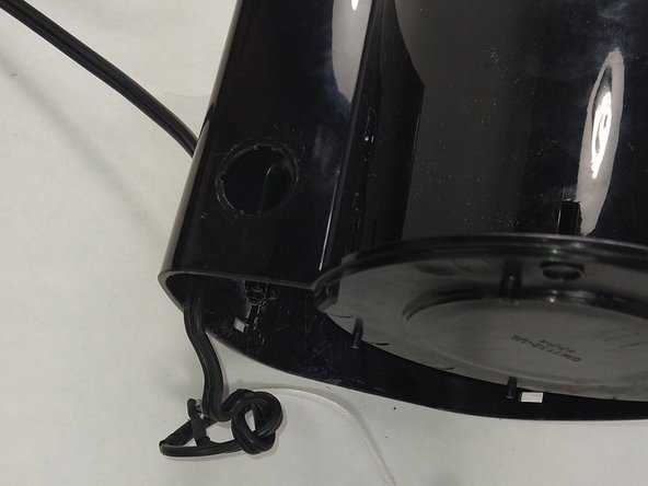

  5. Black and Decker CM0700BZ Power Button Replacement: crwdns2935265:05crwdnd2935265:01crwdnd2935265:03crwdne2935265:0 Black and Decker CM0700BZ Power Button Replacement: crwdns2935265:05crwdnd2935265:02crwdnd2935265:03crwdne2935265:0 Black and Decker CM0700BZ Power Button Replacement: crwdns2935265:05crwdnd2935265:03crwdnd2935265:03crwdne2935265:0
    • Use a screwdriver or spudger to pry out the power button.
