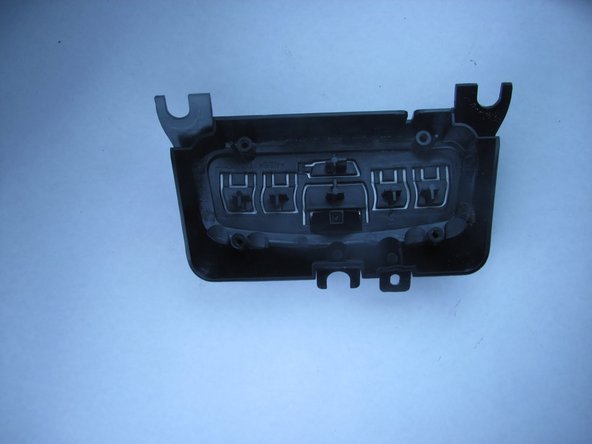

  12. Black and Decker BL3000S button panel replacement: crwdns2935265:012crwdnd2935265:01crwdnd2935265:02crwdne2935265:0 Black and Decker BL3000S button panel replacement: crwdns2935265:012crwdnd2935265:02crwdnd2935265:02crwdne2935265:0
    • Provided is a front and a back view of a functioning button frame from the BL3000S.
    • Check for cracks, bends, debris, or missing extentions and fastens.
