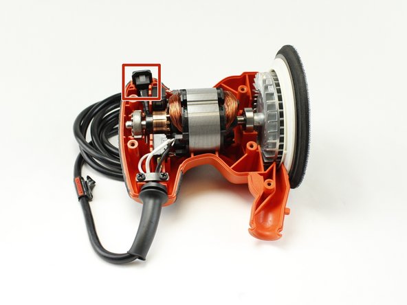

  5. Black and Decker BDERO100 Power Button Replacement, Power Button: crwdns2935265:05crwdnd2935265:01crwdnd2935265:02crwdne2935265:0 Black and Decker BDERO100 Power Button Replacement, Power Button: crwdns2935265:05crwdnd2935265:02crwdnd2935265:02crwdne2935265:0
    • Hold the power button and pull it out of the chassis.
  6. Black and Decker BDERO100 Power Button Replacement: crwdns2935265:06crwdnd2935265:01crwdnd2935265:02crwdne2935265:0 Black and Decker BDERO100 Power Button Replacement: crwdns2935265:06crwdnd2935265:02crwdnd2935265:02crwdne2935265:0
    • Select the cable that connects to the power button.
  7. Black and Decker BDERO100 Power Button Replacement: crwdns2935265:07crwdnd2935265:01crwdnd2935265:01crwdne2935265:0
    • Expose the cable and lock system by peeling off the electric cover.
    • When attaching the new power cord you will need to make sure to cover this lock system with electrical tape.

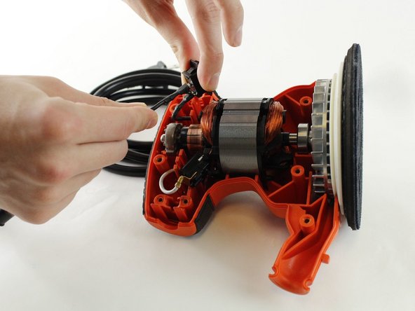

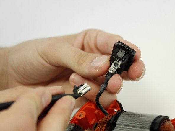

  8. Black and Decker BDERO100 Power Button Replacement: crwdns2935265:08crwdnd2935265:01crwdnd2935265:02crwdne2935265:0 Black and Decker BDERO100 Power Button Replacement: crwdns2935265:08crwdnd2935265:02crwdnd2935265:02crwdne2935265:0
    • Push the security pin with the plastic spudger and simultaneously, pull gently on the cable to separate it from the button

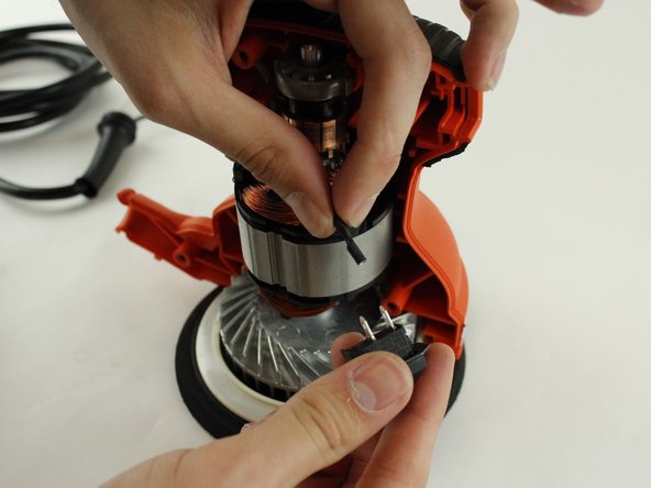

  9. Black and Decker BDERO100 Power Button Replacement: crwdns2935265:09crwdnd2935265:01crwdnd2935265:02crwdne2935265:0 Black and Decker BDERO100 Power Button Replacement: crwdns2935265:09crwdnd2935265:02crwdnd2935265:02crwdne2935265:0
    • Detach the black wire connected to the power button from the motor. To do this, gently pull the cable while holding the power button.
