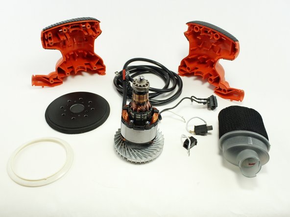

Black and Decker BDERO100 Motor Replacement
  1. Black and Decker BDERO100 Motor Replacement, Hook and Loop System: crwdns2935265:01crwdnd2935265:01crwdnd2935265:01crwdne2935265:0
    • Remove the sanding paper from the velcro.
  2. Black and Decker BDERO100 Motor Replacement: crwdns2935265:02crwdnd2935265:01crwdnd2935265:01crwdne2935265:0
    • Select the JIS - J1 bit or the most appropriate bit to match the screws for your model.
  3. Black and Decker BDERO100 Motor Replacement: crwdns2935265:03crwdnd2935265:01crwdnd2935265:02crwdne2935265:0 Black and Decker BDERO100 Motor Replacement: crwdns2935265:03crwdnd2935265:02crwdnd2935265:02crwdne2935265:0
    • Use the Bit Driver to take off the four 12.5 mm Phillips screws at the base of the hook-and-loop system.
    • Be careful not to lose the lock washers (black rings).
  4. Black and Decker BDERO100 Motor Replacement: crwdns2935265:04crwdnd2935265:01crwdnd2935265:02crwdne2935265:0 Black and Decker BDERO100 Motor Replacement: crwdns2935265:04crwdnd2935265:02crwdnd2935265:02crwdne2935265:0
    • Once all screws and washers have been removed, hold the hook and loop system and separate it from the device.
  5. Black and Decker BDERO100 Motor Replacement, Chassis: crwdns2935265:05crwdnd2935265:01crwdnd2935265:02crwdne2935265:0 Black and Decker BDERO100 Motor Replacement, Chassis: crwdns2935265:05crwdnd2935265:02crwdnd2935265:02crwdne2935265:0
    • Use the nylon spudger to remove the rubber ring from the filter attachment section.
    • The easiest way to do this is to place the spudger sideways and pulling out the ring.
  6. Black and Decker BDERO100 Motor Replacement: crwdns2935265:06crwdnd2935265:01crwdnd2935265:02crwdne2935265:0 Black and Decker BDERO100 Motor Replacement: crwdns2935265:06crwdnd2935265:02crwdnd2935265:02crwdne2935265:0
    • Use the TR20 Torx Security bit driver to unscrew the five 18.75mm Phillips screws from the warning label side of the chassis.
  7. Black and Decker BDERO100 Motor Replacement: crwdns2935265:07crwdnd2935265:01crwdnd2935265:02crwdne2935265:0 Black and Decker BDERO100 Motor Replacement: crwdns2935265:07crwdnd2935265:02crwdnd2935265:02crwdne2935265:0
    • Grab the plastic opening tool and place it on the separation line between both sides of the chassis.
    • Separate both sides and open the device.
    • Be careful not to lose or detach any internal parts while opening the sander.
  8. Black and Decker BDERO100 Motor Replacement: crwdns2935265:08crwdnd2935265:01crwdnd2935265:02crwdne2935265:0 Black and Decker BDERO100 Motor Replacement: crwdns2935265:08crwdnd2935265:02crwdnd2935265:02crwdne2935265:0
    • Hold the chassis and separate it from the device.

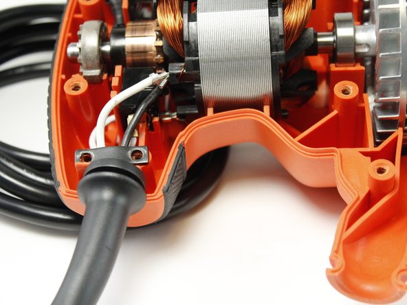

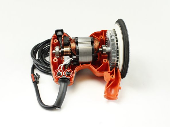

  9. Black and Decker BDERO100 Motor Replacement, Motor: crwdns2935265:09crwdnd2935265:01crwdnd2935265:03crwdne2935265:0 Black and Decker BDERO100 Motor Replacement, Motor: crwdns2935265:09crwdnd2935265:02crwdnd2935265:03crwdne2935265:0 Black and Decker BDERO100 Motor Replacement, Motor: crwdns2935265:09crwdnd2935265:03crwdnd2935265:03crwdne2935265:0
    • Use the bit driver with the JIS - J1 bit to remove the two 12.5 mm phillips screws holding the cord clamp to the chassis.

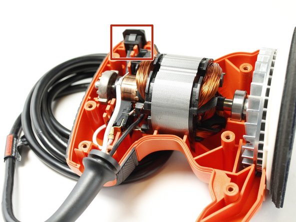

  10. Black and Decker BDERO100 Motor Replacement: crwdns2935265:010crwdnd2935265:01crwdnd2935265:02crwdne2935265:0 Black and Decker BDERO100 Motor Replacement: crwdns2935265:010crwdnd2935265:02crwdnd2935265:02crwdne2935265:0
    • With yout hands, hold and separate the power button from the external case by pulling gently.

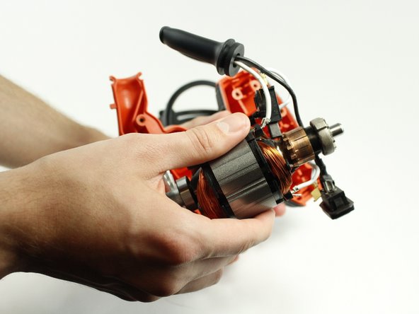

  11. Black and Decker BDERO100 Motor Replacement: crwdns2935265:011crwdnd2935265:01crwdnd2935265:02crwdne2935265:0 Black and Decker BDERO100 Motor Replacement: crwdns2935265:011crwdnd2935265:02crwdnd2935265:02crwdne2935265:0
    • Hold the motor and gently pull to remove from chassis.

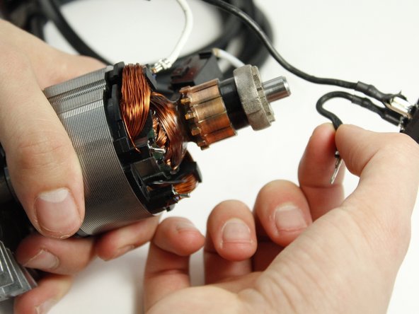

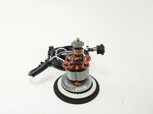

  12. Black and Decker BDERO100 Motor Replacement: crwdns2935265:012crwdnd2935265:01crwdnd2935265:03crwdne2935265:0 Black and Decker BDERO100 Motor Replacement: crwdns2935265:012crwdnd2935265:02crwdnd2935265:03crwdne2935265:0 Black and Decker BDERO100 Motor Replacement: crwdns2935265:012crwdnd2935265:03crwdnd2935265:03crwdne2935265:0
    • Gently pull on all cables connected to the motor to remove.
  13. Black and Decker BDERO100 Motor Replacement: crwdns2935265:013crwdnd2935265:01crwdnd2935265:02crwdne2935265:0 Black and Decker BDERO100 Motor Replacement: crwdns2935265:013crwdnd2935265:02crwdnd2935265:02crwdne2935265:0
    • Once all cables are disconnected, you can proceed to replace the motor.
