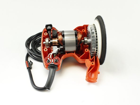

    • Use the bit driver with the JIS - J1 bit to remove the two 12.5 mm phillips screws holding the cord clamp to the chassis.
  6. Black and Decker BDERO100 Holder Brush and Spring Replacement: crwdns2935265:06crwdnd2935265:01crwdnd2935265:02crwdne2935265:0 Black and Decker BDERO100 Holder Brush and Spring Replacement: crwdns2935265:06crwdnd2935265:02crwdnd2935265:02crwdne2935265:0

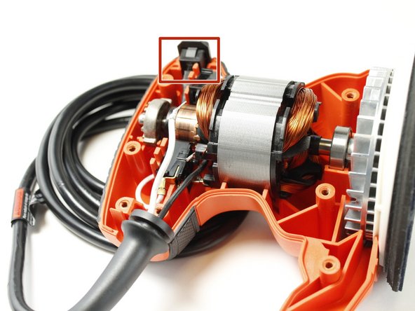

    • With yout hands, hold and separate the power button from the external case by pulling gently.
  7. Black and Decker BDERO100 Holder Brush and Spring Replacement: crwdns2935265:07crwdnd2935265:01crwdnd2935265:01crwdne2935265:0

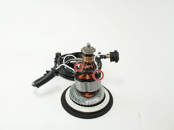

    • Identify the white cables connected to the holder brush and spring.
  8. Black and Decker BDERO100 Holder Brush and Spring Replacement: crwdns2935265:08crwdnd2935265:01crwdnd2935265:02crwdne2935265:0 Black and Decker BDERO100 Holder Brush and Spring Replacement: crwdns2935265:08crwdnd2935265:02crwdnd2935265:02crwdne2935265:0
    • Hold the motor and gently pull to remove from chassis.

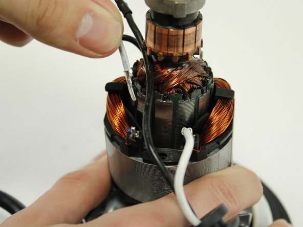

  9. Black and Decker BDERO100 Holder Brush and Spring Replacement: crwdns2935265:09crwdnd2935265:01crwdnd2935265:03crwdne2935265:0 Black and Decker BDERO100 Holder Brush and Spring Replacement: crwdns2935265:09crwdnd2935265:02crwdnd2935265:03crwdne2935265:0 Black and Decker BDERO100 Holder Brush and Spring Replacement: crwdns2935265:09crwdnd2935265:03crwdnd2935265:03crwdne2935265:0
    • Remove the wire connected to the brush holder from the motor by pulling gently.

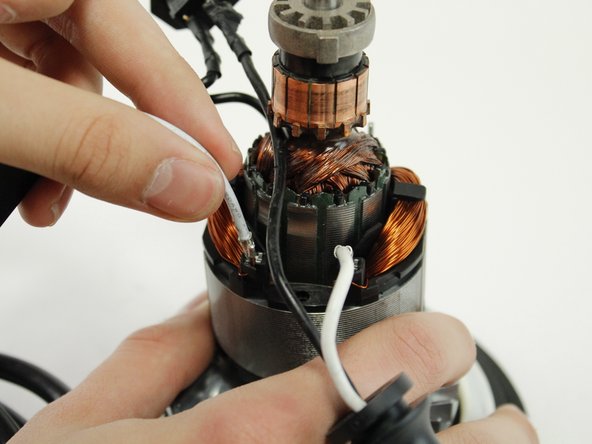

  10. Black and Decker BDERO100 Holder Brush and Spring Replacement: crwdns2935265:010crwdnd2935265:01crwdnd2935265:03crwdne2935265:0 Black and Decker BDERO100 Holder Brush and Spring Replacement: crwdns2935265:010crwdnd2935265:02crwdnd2935265:03crwdne2935265:0 Black and Decker BDERO100 Holder Brush and Spring Replacement: crwdns2935265:010crwdnd2935265:03crwdnd2935265:03crwdne2935265:0
    • Make a note of where each wire should be, you will avoid making wiring mistakes when assembling the device.
