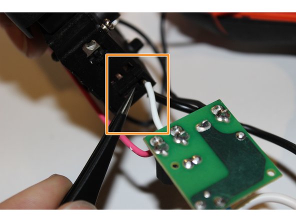

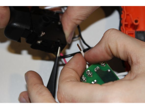

  5. Black and Decker BDEDMT Trigger Device Replacement: crwdns2935265:05crwdnd2935265:01crwdnd2935265:03crwdne2935265:0 Black and Decker BDEDMT Trigger Device Replacement: crwdns2935265:05crwdnd2935265:02crwdnd2935265:03crwdne2935265:0 Black and Decker BDEDMT Trigger Device Replacement: crwdns2935265:05crwdnd2935265:03crwdnd2935265:03crwdne2935265:0
    • Located on the bottom side there will be a labeled area with a number 2. Below the two there will be a short white wire.
    • Using your needle nose tweezers insert one of the ends into the release slot below the white wire.
    • Make sure aim the tweezers toward the wire.
    • Lift the end of the tweezers to release the wire.
    • Do not force the removal of the wire.
