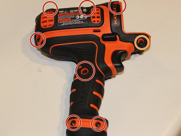

  2. Black and Decker BDEDMT Motor Replacement, Remove Mounting Hardware: crwdns2935265:02crwdnd2935265:01crwdnd2935265:03crwdne2935265:0 Black and Decker BDEDMT Motor Replacement, Remove Mounting Hardware: crwdns2935265:02crwdnd2935265:02crwdnd2935265:03crwdne2935265:0 Black and Decker BDEDMT Motor Replacement, Remove Mounting Hardware: crwdns2935265:02crwdnd2935265:03crwdnd2935265:03crwdne2935265:0
    • Using a JIS 1 screwdriver, unscrew seven 19mm outer screws located on the armature.
    • Using the same screwdriver, unscrew the 12mm outer screw located on the armature.

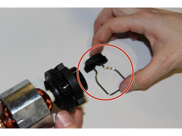

  4. Black and Decker BDEDMT Motor Replacement: crwdns2935265:04crwdnd2935265:01crwdnd2935265:02crwdne2935265:0 Black and Decker BDEDMT Motor Replacement: crwdns2935265:04crwdnd2935265:02crwdnd2935265:02crwdne2935265:0
    • Slide off the the black framework on the barring side.
    • You may have to compress the magnets in order to slide the framework off of the barring.

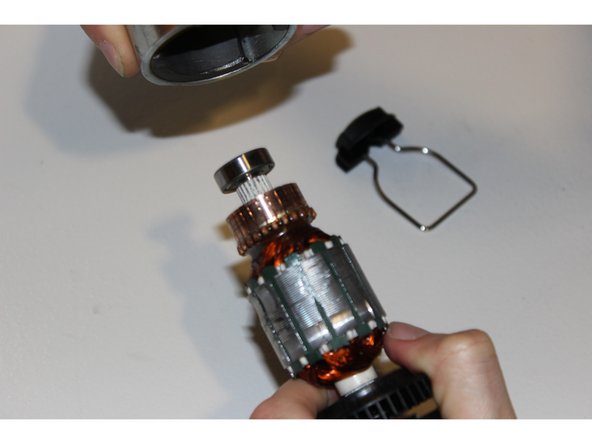

  5. Black and Decker BDEDMT Motor Replacement: crwdns2935265:05crwdnd2935265:01crwdnd2935265:02crwdne2935265:0 Black and Decker BDEDMT Motor Replacement: crwdns2935265:05crwdnd2935265:02crwdnd2935265:02crwdne2935265:0
    • Remove the release button attached at the front of the motor.
    • It may have already come off during Step 3.
  6. Black and Decker BDEDMT Motor Replacement: crwdns2935265:06crwdnd2935265:01crwdnd2935265:02crwdne2935265:0 Black and Decker BDEDMT Motor Replacement: crwdns2935265:06crwdnd2935265:02crwdnd2935265:02crwdne2935265:0
    • Work the silver magnetic ring off of the motor through the barring end.
    • The motor is now free.
